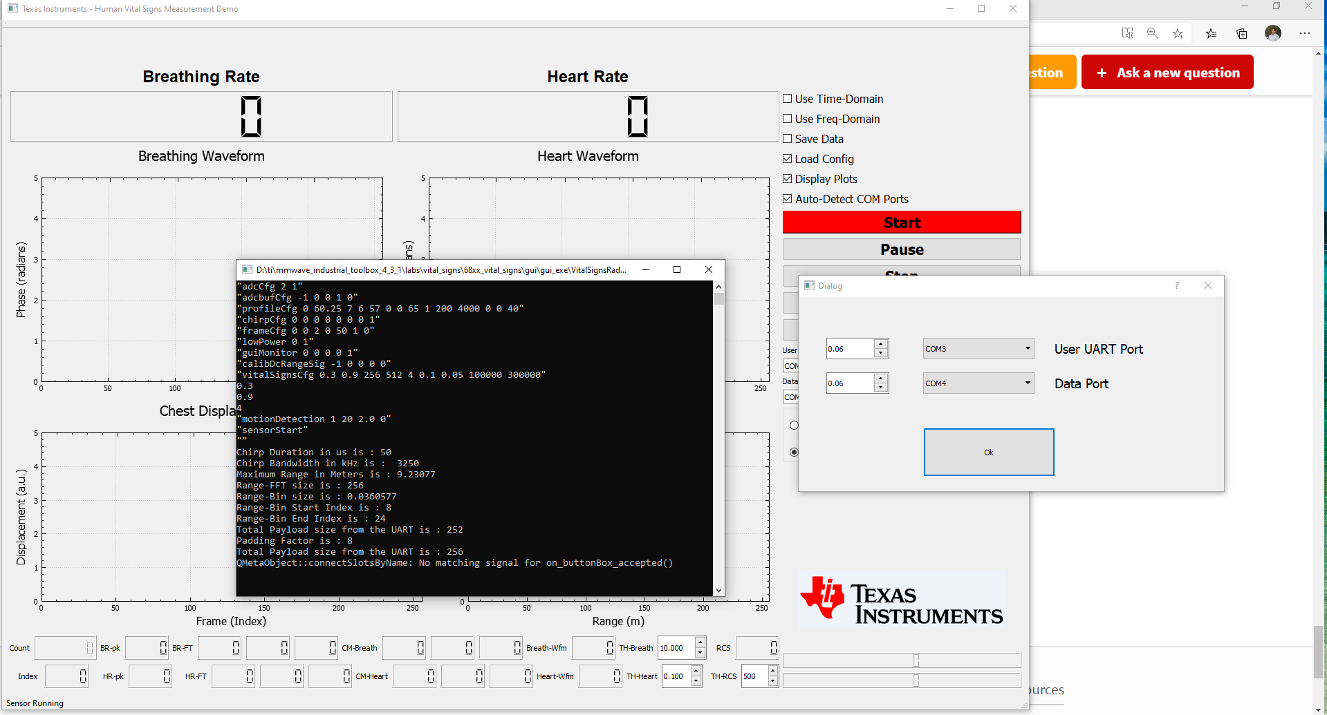

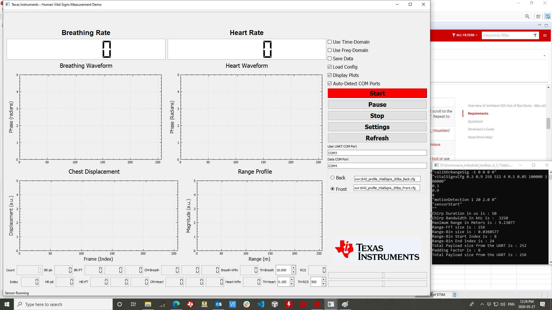

    Flashed the SFLASH then, downloaded the bin file for vital signs lab and again nothing showing up on the GUI plot as you can see in this post.
    Here is the output from GUI command window:
    QT version = 5.9.1
    QMetaObject::connectSlotsByName: No matching signal for on_buttonBox_accepted()
    Serial Port Found
    Data Port Number is "COM4"
    User Port Number is "COM3"
    Data port succesfully Open
    User port succesfully Open
    Configuration File Name Read from the GUI is %s/n "xwr1642_profile_VitalSigns_20fps_Back.cfg"
    "COM3"
    Configuration File Path is %s/n "D:/ti/mmwave_industrial_toolbox_4_3_1/labs/vital_signs/68xx_vital_signs/gui/profiles/xwr1642_profile_VitalSigns_20fps_Front.cfg"
    "sensorStop"
    "flushCfg"
    "dfeDataOutputMode 1"
    "channelCfg 15 3 0"
    "adcCfg 2 1"
    "adcbufCfg -1 0 0 1 0"
    "profileCfg 0 60.25 7 6 57 0 0 65 1 200 4000 0 0 40"
    "chirpCfg 0 0 0 0 0 0 0 1"
    "frameCfg 0 0 2 0 50 1 0"
    "lowPower 0 1"
    "guiMonitor 0 0 0 0 1"
    "calibDcRangeSig -1 0 0 0 0"
    "vitalSignsCfg 0.3 0.9 256 512 4 0.1 0.05 100000 300000"
    "motionDetection 1 20 2.0 0"
    "sensorStart"
    "sensorStop"
    "flushCfg"
    "channelCfg 15 3 0"
    "adcCfg 2 1"
    "lowPower 0 1"
    0.3
    0.9
    4
    "sensorStart"
    Chirp Duration in us is : 50
    Chirp Bandwidth in kHz is : 3250
    Maximum Range in Meters is : 9.23077
    Range-FFT size is : 256
    Range-Bin size is : 0.0360577
    Range-Bin Start Index is : 8
    Range-Bin End Index is : 24
    Total Payload size from the UART is : 252
    Padding Factor is : 8
    Total Payload size from the UART is : 256
  • Please see the attached photo

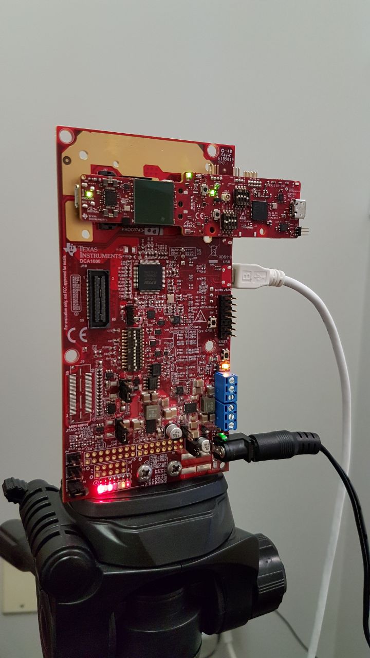

  • Here is also the hardware setup for your kind review:

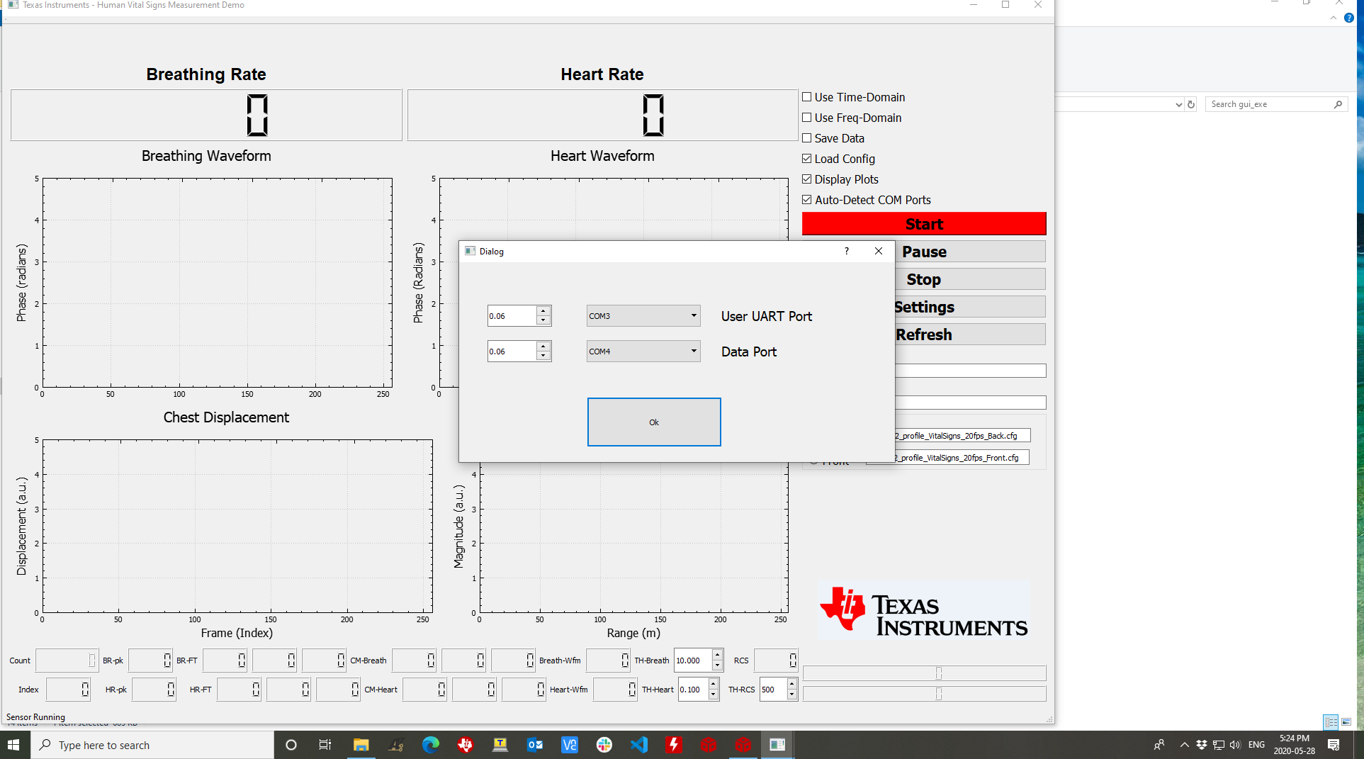

    Can you please verify that when you open the GUI executable and go into settings that you can see that the COM ports are present for both data and user. And if the fields are blank that means that the GUI can not see them. If that is the case I need you to run the OOB in your setup even if worked in the past so that we can verify that data can be sent from ICBOOST to your machine. Do this and we can move forward.
    Connor Desmond
    Thanks for your follow-up.
    Please take a look at the attached picture. These fields are filled correctly as you can see. However when I click on the settings, a message is shown on the command line window as attached here.

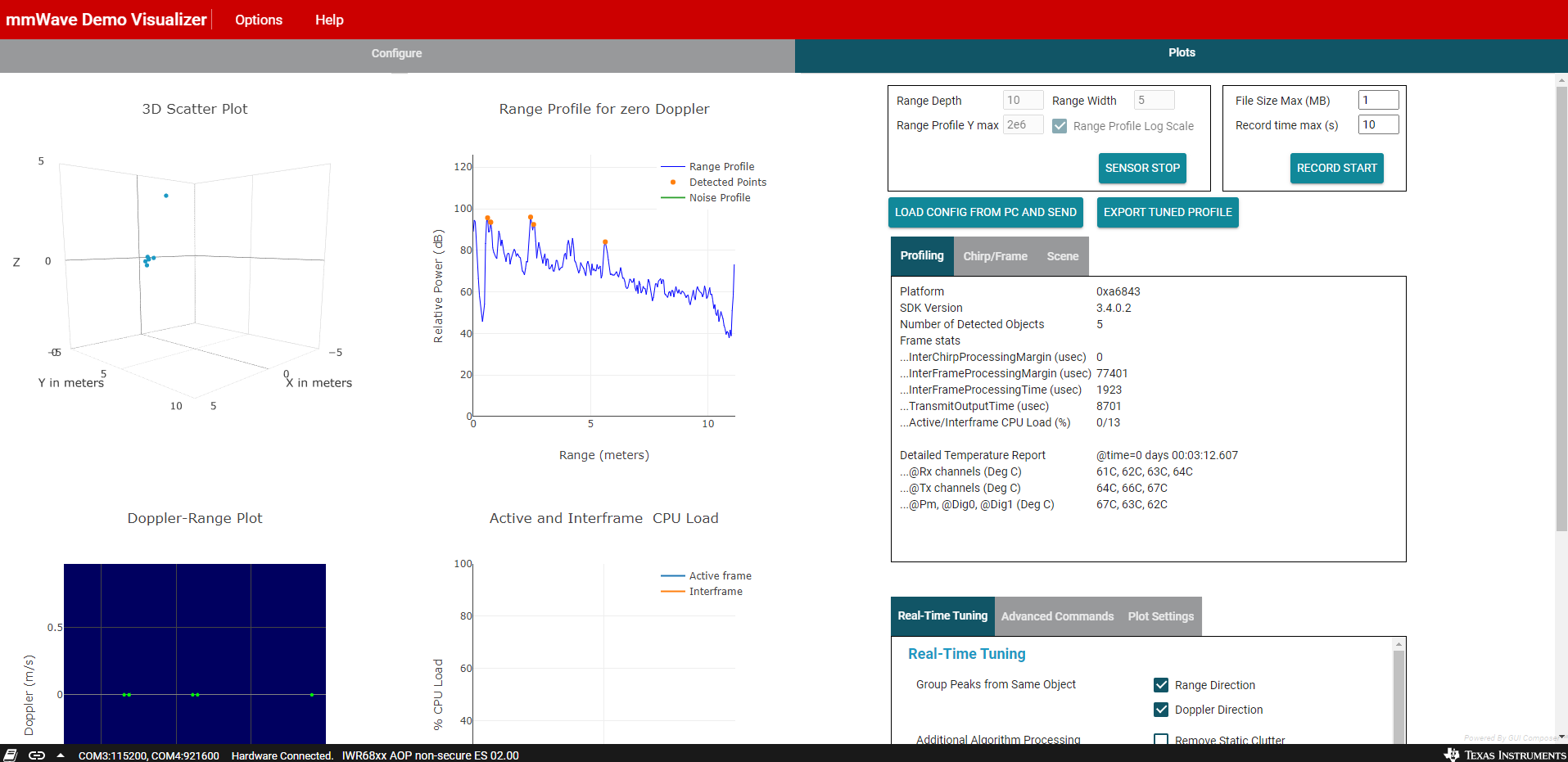

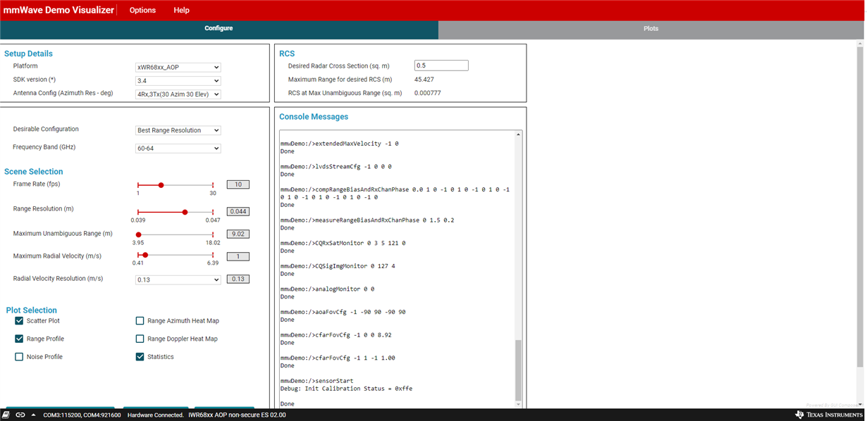

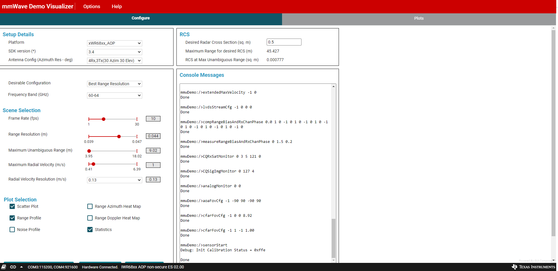

  • Dear Connor,
    Please see the following photos as I run the OOB lab.
    Everything seems to be working in the OOB lab but there seems to be a problem with the vital signs GUI. Please advise what should be the next debugging step?

  • Dear Watmil,
    Currently we do not support the Vital Signs Demo for the IWR6843AOP ES2.0 device. The provided binaries only work with ES1.0 devices.
    Connor Desmond
  • Dear Connor,
    Thanks for your response. You mean the Rev. C of IWR6843AOP? The one that is deprecated? I have one of those too. Will try the lab on it and will post the results here in this thread so others can use the information provided here, too.
