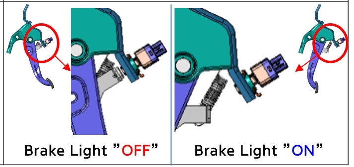

    Stop Lamp Switch  PCB Dimension is as below
    Sensor coil will be mounted on the 8.5mm width PCB.
    Also, what is the shape of the target and what is the maximum distance the target is expected to be at ?
    Distance requirent is More than 5mm between Stop Lamp Sennor and Pedal(Iron).
    In other word less than 5mm brake_lamp should not be turned on.
    So we need to know how to enlengthen the sensing disance.
    Best Regards.

    Thanks for the pictures these help.
    Can you please help me understand with the following questions ? One of the challenges with this implementation is that the target does not seem to be approaching vertically from the sensor.
    A) What is the diameter of the target approaching the sensor ?
    B) What is the material of the target ?
    C) What is the thickness of the target ?
    D) Has customer run any simulation to gives us a profile of the distance vs inductance by running simulations through either FEMM or Ansys ? If we can get the inductance measurement when the target is farthest vs the target approaching we can look into providing more guidance.
