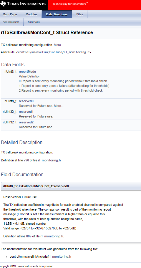

       Yes, IWR684 ES2 would support the directional couplers. It is part of monitoring API. Currently monitoring API firmware is under development would be available 2nd half of this year.
    Once firmware is avaiable you could make use of below API from the SDK.
    For the directional couplers could be used from the SDKs mmWave link functions.
    Its included in Tx ball break monitoring APIs

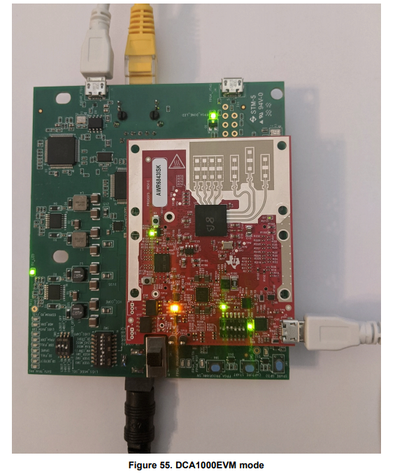

    On the EVM side connecting to directly to DCA1000:
    We have launched new AWR6843ISK EVM which could be directly connected to DCA1000 without using MMWAVEICBOOST board.
       https://www.ti.com/tool/AWR6843ISK
    As shown below:
    For the IWR6843 devices also this EVM would be available by next month. Not for the reference you could use AWR6843ISK hardware (Schematic and Layout would be available in the above link)

    mmWave studio doesn't use the XDS110 connection or JTAG connections, However mmWave studio needs UART Ports (RS232 Tx and Rx) lines for the firmware download. This need to be connected to DCA1000 FTDI's UART ports.
    If you follow the pin-out of the DCA1000 connector on the IWR6843ISK board then you could connect to mmWave studio directly.
