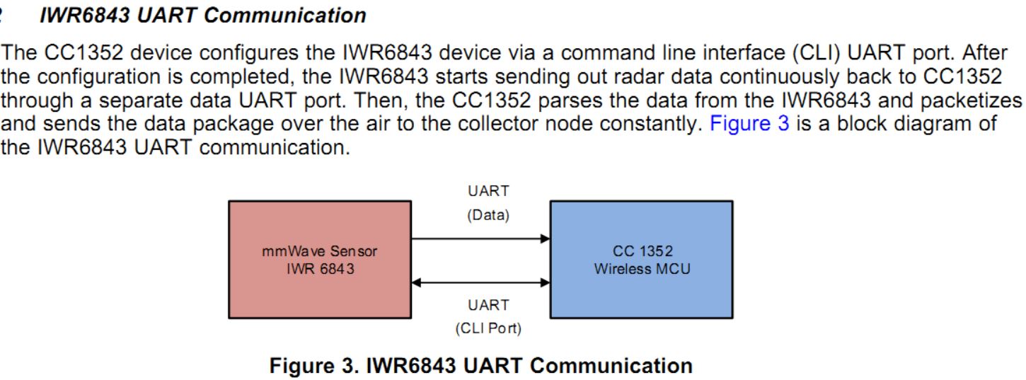

I looked at document TIDA-010022 from TI, but there's no source code of it. After reading, I wanna ask:
1. wifi module in that document is CC1352. In order to communicate between IWR6843 & CC1352 via UART, both modules must modify some parts. Do I need to modify in case I connect IWR6843 & CC3235 via UART? If yes, which part do I need to add/remove? In the document, it mentions MMWAVEICBOOST needs to add R81, R122 but doesn't say which value of resistor I need to use. Please tell me in details in case I use CC3235.
2. on CC1352, it must remove SMA connector before connecting to IWR6843. How about CC3235?
3. on CC1352, it must removethe following jumpers: "5V", "3V3", "RXD", and "TXD" and switch the XDS110 power jumper to "Extern" Power. On CC3235, I don't see 3V3 jumper. Is it VBAT or BRD jumper? Do I have to remove both VBAT & BRD jumper?
4. How to switch XDS110  to Extern Power?

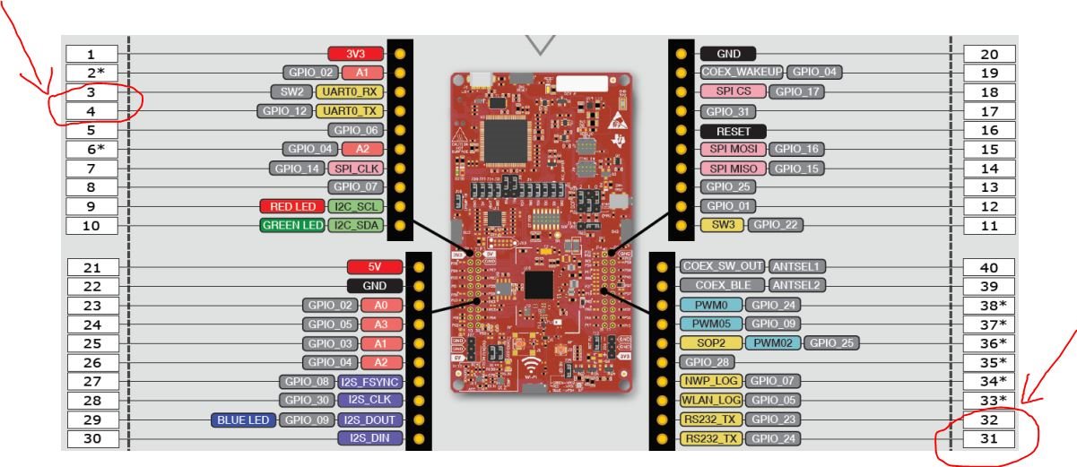

5. Which pins do I need to connect for UART communication? As I understand, connect P1.3 on CC3235 to pin 5 of J5 connector and connect P1.4 on CC3235 to pin 7 of J5 connector  on MMWAVEICBOOST, right?
6. As in the photo below, please explain the difference between UART (data port ) and UART (CLI port). As I know, IWR6843 MMWAVEBOOST EVM and CC3235 only have 1 USB port. How can they communicate via 2 separate UART port?
In short, please give me instruction with schematic diagram for wiring between IWR6843 & CC3235 via UART, resistor value for hardware modification on 2 modules, ect...

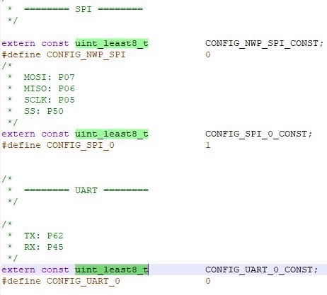

    1. I'm using IWR68-ISK attach to MMWAVEICBOOST.
    2. Here's my CC3235S pin settings on SysConfig. So I must use P62 as TX and P45 as RX for UART communication to IWR6843 MMWAVEICBOOST, right? Previously, I thought I need to use P04 and P03 for UART.
    3. In SimpleLink SDK, I don't see main_mss.c program. There're 2 types free-RTOS, TI-RTOS. . Which type should I choose as a base project? Besides, in each type has CCS, GCC folder. After flashing, which bin file (ccs or gcc) should I flash on device?
    4. On MMWAVEICBOOST, document says I need to add R122, but I can't find location of R122. Where's it and which value of resistance needed?

  • Dear Connor,
    1. How to enable MSS_Logger pin on MMWAVEICBOOST to send data? I see it's in pin 9 of J6 connector. But not sure which pinmux settings code can I write for it. I think MSS_LOGGER is UART-3 when we do pinmux settings (corresponds MSS_UARTB_TX in datasheet, right? On some module such as AWR1843BOOST, MSS_Logger is not connected but has to be enabled by soldering a resistor to the circuit. How about IWR6843-ISK?
    Here's my draft code for Mss_logger write data from IWR6843

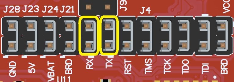

  • Connor,
    About UART read from IWR6843 to CC3235, I connected UART0 & UART1 of IWR6843 to CC3235. I sent Cfg directly from PC to IWR6843, then pin MSS_Logger connects to UART1_RX of CC3235. But when I used Teraterm, I saw no data on UART data port of CC3235 even though I saw point cloud on IWR6843. If I send Cfg to IWR6843 directly from PC, do I need to modify the code of CC3235 sensor node to not send Configuration parameters?
    As I see, in order to transfer data via boosterpack header, we must set J9 jumper to bottom side. So how can you check whether CC3235 can receive data from IWR6843 correctly via Teraterm in case we can't set J9 jumper on CC3235 for COM port and boosterpack at once?
    I tried to connect 3 pins of RX J9 jumper on CC3235S to transfer data and check data received from MSS_LOGGER pin IWR6843. LED D7 lights green, but Teraterm still shows nothing on data port of CC3235S. What may cause this issue?
  • Hector,

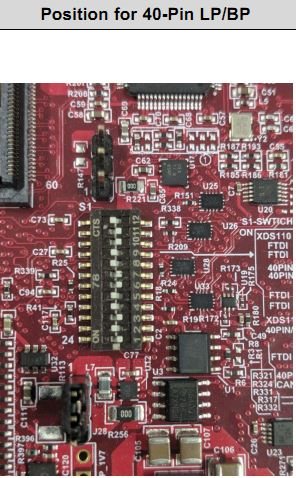

    I used oscilloscope to check signal on both Mss_logger pin and pin 45 (UART1_RX on CC3235). Mss_logger voltage is always at high level (about 33~35V). It means radar hasn't been initialized (hasn't received Cfg settings) successfully. Please tell me how to solve it. Here's the code I used to send Cfg from CC3235S to IWR6843 and to receive data from Mss_logger pin. After that, I put mmwaveTaskInit(); in main_tirtos.c of CC3235S project. And the result is 6843 uninitialized as mentioned above.
    Note: I set switch S1.1~S1.12 to enable 40-pin connector on MMWAVEICBOOST, and I flashed demo code for IWR6843
