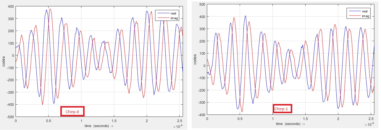

My configuration for BPM is as follows: Only one antenna channel is enabled, all receiving channels are enabled. I set two chirp, The first chirp is in the 0 phase and the second chirp is in the 180 phase.The frame configuration is:chirpStartIdx:0    chirpEndIdx:1    numloops:64.
We watched the doppler fft data.We think BPM don't work because there is a spectrum only in a specific place.

  • Configuration you are setting is slightly wrong.
    E.g. frameConfig: chirpStartIdx=0, chirpEndIdx=1, numLoop=10 (total 20*2 chirps in a frame)
    and each chirp is configured with Tx0 only
    Then BPM Config:
    bpmCfgArgs_master[0].chirpEndIdx = 0;
    bpmCfgArgs_master[0.chirpStartIdx = 0;
     bpmCfgArgs_master[0].constBpmVal =0;
    bpmCfgArgs_master[0].reserved =0;
    bpmCfgArgs_master[1].chirpEndIdx = 1;
    bpmCfgArgs_master[1].chirpStartIdx = 1;
     bpmCfgArgs_master[1].constBpmVal =1; /* Tx0 ON: 180 degree */
    bpmCfgArgs_master[1].reserved =0;
    bpmCfgArgs_slaver1[0].chirpEndIdx = 0;
    bpmCfgArgs_slaver1[0.chirpStartIdx = 0;
    bpmCfgArgs_slaver1[0].constBpmVal =0;
    bpmCfgArgs_slaver1[0].reserved =0;
    bpmCfgArgs_slaver1[1].chirpEndIdx = 1;
    bpmCfgArgs_slaver1[1].chirpStartIdx = 1;
     bpmCfgArgs_slaver1[1].constBpmVal =1; /* Tx0 ON: 180 degree */
    bpmCfgArgs_slaver1[1].reserved =0;
     To verify you can use mmwave Studio to configure, capture then post-proc : time domain plot you could see alternate 0/180 degree amplitude.
    Here is snapshot of two chirp time-domain plot, where you can see sinosoid is changed by 180 degree.
    Jitendra

  • I I plot time domain time , I still can't see alternate 0/180 degree amplitude. It seems BPM is still not working.
    And I I try to use advance chirp to config BPM.But  my results were the same.
    I recommend using mmwave studio first to verify your usecase with BPM feature and plot using PostProc as I did in above reply.
    http://www.ti.com/tool/MMWAVE-STUDIO (mmwave Studio -2G)
    Jitendra
