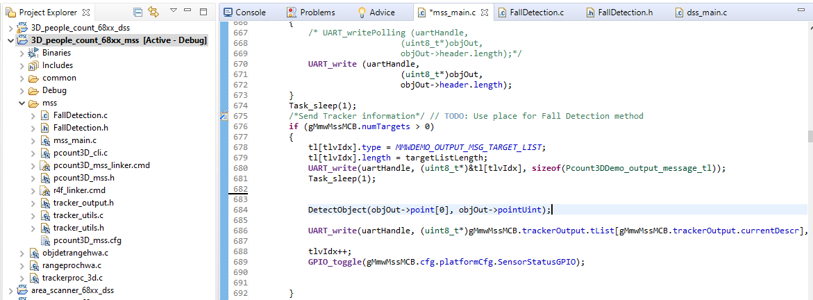

I'm using the IWR6843ISK-ODS sensor together with the People Counting demo Code to create a Human Fall Detection system.
At the moment i placed my own method in the mss_main.c file around line 680.
This is the spot that sends the Data Format to the GUI using the UART and my own code uses it because i want to use the GPIO_2 Led:
But i'm a little stuck at calculating the range of the object.
I decompress the values from the Data Format and multiply the Range with the Range Unit.
But i'm only getting wrong values.
Am i using the wrong calculation? Or do i use the wrong object code?
(I'm using the objOut variable from the gMmwMssMCB.pointCloudToUart because somehow the gMmwMssMCB.trackerOutput.tList[gMmwMssMCB.trackerOutput.currentDescr] variable that gets Written to the UART is empty when i try to use it.)
