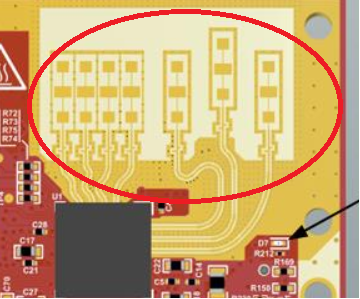

What is the material used to cover the RX and TX antennas and what is its purpose ?

Could you please provide more information on the request, are you looking for information on radomes to cover TX and RX ?
Or something else? Could you please show with picture?

On the area you have highlighted: Copper is etched out hence what you would see white material is Rogers (RO4835LOPRO) substrate.
On the other regions where copper is not etched, you would see silver color on the traces and antenna, This is due to plating.Most common plating used in industry, Electroless Nickel-Immersion Gold (ENIG), is not a good choice for mmWave boards due to its high losses. TI EVM uses immersion silver plating that has lesser loss, comparatively.
For more details on this you could refer to the below app-note
http://www.ti.com/lit/an/spracg5/spracg5.pdf

Thank you for your clear reply.
A misunderstanding on my part.
