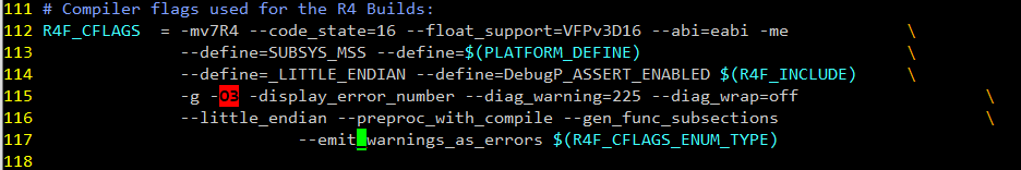

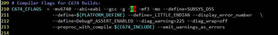

  • Hi Kazuki-san,
    All the DPUs (inlcuding DPU_AoAProcDSP_process) are compiled as libraries using makefiles. The CCS projects provided in Industrial Toolbox link the pre-compiled libs from the SDK. So changes made to the compile options (e.g. optimization settings) in the CCS projects "mmwave_sdk_68xx_dsp_dss" and "mmwave_sdk_68xx_dsp_mss" do not have an effect on the DPUs since those are pre-compiled libs (built with O3 optimization by default).
    So in order to debug the DPU code (or any pre-compiled library), you need to:
    1. Re-compile the corresponding DPU libs using the SDK makefile method. This is described in the SDK user guide under section 4.5 (developing using SDK).
      1. Before re-building the DPU code for debug, you need to remove the -O3 flag from the SDK common makefile to enable statement level debugging.
      2. To do so, change the R4F_CFLAGS and C64X_CFLAGS defines as shown below in C:\ti\mmwave_sdk_03_04_00_03\packages\ti\common\mmwave_sdk.mak and re-build the DPU lib. Note that this may increase the memory requirements and/or break real-time behavior because of un-optimized compilation.
    2. Next, re-build the mmwave demo using the CCS project as you did already. This is needed to re-link the new DPU lib.
    -Nitin
