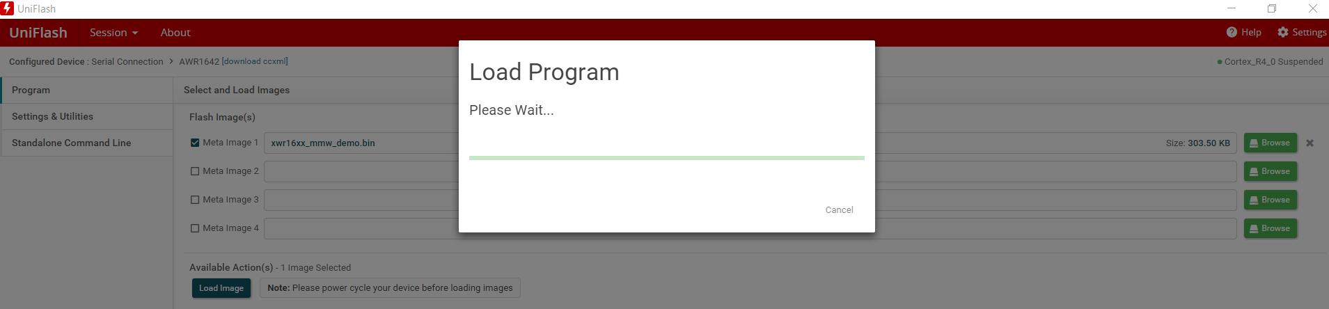

I have a Rev B AWR1642BOOST board.
When I tried to run the mmWave out of the box demo, the SDK version on the hardware was reported as [2,0]. The demo does not support that version anymore.
So I downloaded the latest mmWave SDK (version: 3.04.00.03) and located the *.bin file of the demo for my board. (I also installed mmWave SDK version 2.01.00.04 but observed exactly the same problem reported below)
I went to Uniflash and specified that *.bin file to be flashed to my device. My device was successfully autodetected, which tells me Uniflash can link to the AWR1642BOOST at least.
I also made sure SOP (101) jumpers were configured as required to make sure the board was in the flash state. (I power cycled the board BEFORE attempting to load the *.bin file as well)
When I hit the "Load Image" button, the program gets stuck as follows. I see no progress once that display is shown. (I terminated the program a few times and restarted my PC but the result did not change)
I gave up on loading the *.bin file and tried to erase the flash ONLY but observed the same behavior.

  • Hi Cesar,
    I had a look at the link you shared. Besides the bullet on trying a new machine, all other steps in that link were already tested.
    So I installed all of the tools on a Linux Ubuntu 18.04 machine and tested the flashing there. This time it worked on first trial. I was successfully able to upgrade the SDK on the EVM to version 3.4.
    It looks like the problem may be related to the Windows 10 USB drivers. I tried the cloud as well as the desktop version of the Uniflash on Win 10 and power cycled my PC a few times on multiple retries but nothing worked.
    One interesting observation is the demo (after being flashed to the EVM on Ubuntu machine) works reliably on the Win 10 machine. So the problem comes down to the difference between the flashing and the normal operation of the board using Windows 10.
