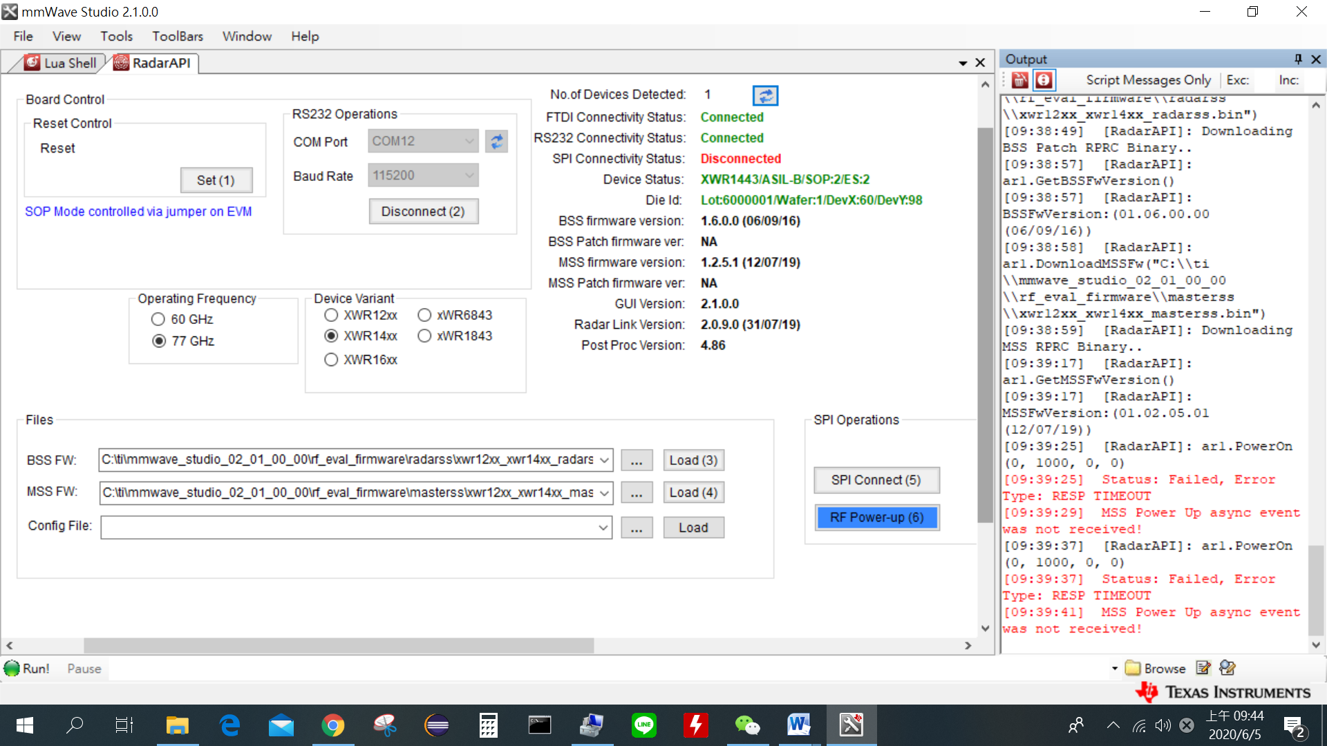

i am using awr1443 boost with DCA 1000 to perform. mmwave studio version is 2.1.0.0 or 2.1.1.0. after load firmware the "BSS Patch firmware" is NA, and click "SPI connect" and "RF Power-up" the error message is
[15:02:36] Device Status : XWR1443/ASIL-B/SOP:2/ES:2
[15:02:36] [RadarAPI]: ar1.RfEnable()
[15:02:38] Status: Failed, Error Type: RESP TIMEOUT
[15:02:42] BSS Power Up async event was not received!
i also try to erase sflash by uniflash before experiment.

    [09:38:49] [RadarAPI]: ar1.DownloadBSSFw("C:\\ti\\mmwave_studio_02_01_00_00\\rf_eval_firmware\\radarss\\xwr12xx_xwr14xx_radarss.bin")
    [09:38:49] [RadarAPI]: Downloading BSS Patch RPRC Binary..
    [09:38:57] [RadarAPI]: ar1.GetBSSFwVersion()
    [09:38:57] [RadarAPI]: BSSFwVersion:(01.06.00.00 (06/09/16))
    [09:38:58] [RadarAPI]: ar1.DownloadMSSFw("C:\\ti\\mmwave_studio_02_01_00_00\\rf_eval_firmware\\masterss\\xwr12xx_xwr14xx_masterss.bin")
    [09:38:59] [RadarAPI]: Downloading MSS RPRC Binary..
    [09:39:17] [RadarAPI]: ar1.GetMSSFwVersion()
    [09:39:17] [RadarAPI]: MSSFwVersion:(01.02.05.01 (12/07/19))
    [09:39:25] [RadarAPI]: ar1.PowerOn(0, 1000, 0, 0)
    [09:39:25] Status: Failed, Error Type: RESP TIMEOUT
    [09:39:29] MSS Power Up async event was not received!
    BSS FW: C:\ti\mmwave_studio_02_01_00_00\rf_eval_firmware\radarss\xwr12xx_xwr14xx_radarss.bin
    MSS FW: C:\ti\mmwave_studio_02_01_00_00\rf_eval_firmware\masterss\xwr12xx_xwr14xx_masterss.bin

  • First, I using SOP 5 (Flash programming) to flash firmware by uniflash.
    Second, power cycle awr1443, and SOP set SOP 4 (Functional mode), click mmWave Studio "Reset" - > "SPI Connect", the error message as below,
    [09:27:40] ***Script completed successfully.***
    [09:28:48] [RadarAPI]: Opening Gpio Control Port()
    [09:28:48] [RadarAPI]: Status: Passed
    [09:28:49] [RadarAPI]: Opening Board Control Port()
    [09:28:49] [RadarAPI]: Status: Passed
    [09:28:50] [RadarAPI]: ar1.FullReset()
    [09:28:50] [RadarAPI]: Status: Passed
    [09:28:50] [RadarAPI]: Closing Board Control Port()
    [09:28:50] [RadarAPI]: Closing Gpio Control Port()
    [09:28:50] [RadarAPI]: ar1.SOPControl(2)
    [09:29:05] [RadarAPI]: ar1.Connect(12,115200,1000)
    [09:29:07] [RadarAPI]: Error: Connection failed: Calling_ConnectTarget returned 3
    [09:29:07] [RadarAPI]: ar1.Calling_IsConnected()
    [09:29:07] [RadarAPI]: ar1.SaveSettings('C:\Users\LUCY\AppData\Roaming\RSTD\ar1gui.ini')
    [09:29:16] [RadarAPI]: ar1.PowerOn(0, 1000, 0, 0)
    [09:29:16] Status: Failed, Error Type: RESP TIMEOUT
    [09:29:20] MSS Power Up async event was not received!
    Could you check if the USB cable is connected to DCA1000 EVM at the right USB connector which is marked as ‘RADAR_FTDI’.
