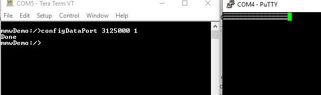

    Could you once try this baudrate with serial terminal in the Linux env?
    Open CMD Port @115200 and Data Port @3125000 from Putty.
    Send 'configDataPort 3125000 1' command over CMD Port, the application will ack on data port with 0xFF sequence.
    Another option to verify your Linux env for this baudrate is to modify the application for '3125000' for CMD Port, build and flash this modified application. You should see the 'mmwDemo:/>' prompt at the serial terminal.
    Change: mss_main.c->  MmwDemo_platformInit() ::    config->commandBaudRate     = 3125000;//115200;
