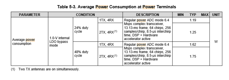

customer needs to estimate the power consumption. Do we have a excel sheet like swrm019.zip for IWR6843? Are the any reference designs with power numbers?

Holger,
Currently we do not have power calculator similar to swrm019.zip. But you could use the same calculator to understand the trends of number of tx/rx, sampling rate, samples/chirp, Duty-cycle scaling etc.
As a guidelines, you could refer to the power consumption number from IWR6843 device, This would be applicable to AOP device as well.
