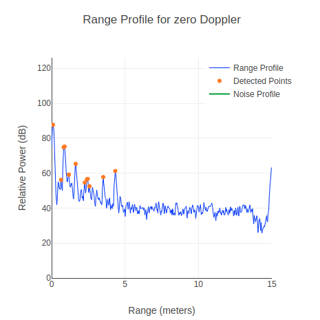

I have the radar sensor AWR1843BOOST and I need to save the acquired data for my research work as a Ph.D. student. I have used the python script to parse the binary data that I acquire with the Demo visualizer, However, that script is faulty. The data I need to save is the range profiler plot:
However, when I try o parse this data from the .dat file I get this:
        RangeProf[0]:	011.812 11.812500
	RangeProf[1]:	012.410 12.410156
	RangeProf[2]:	012.560 12.559570
	RangeProf[3]:	012.964 12.963867
	RangeProf[4]:	013.163 13.163086
	RangeProf[5]:	012.814 12.814453
	RangeProf[6]:	012.103 12.102539
I can not find a possible association with the plot in the image
    Is the python script you are using provided with the SDK release? I don't think the SDK provides such a script.
    I have seen in the past a python script that was used, however it no longer matched the Visualizer used by the latest SDK version.
    You will probably need to modify the python script to match the latest SDK format.
    Unfortunately the SDK does not include such  a script and we would have to rely on the forum community

    I contacted the support and they sent me the python script that I have attached.
    Maybe it is an outdated script. I also have documentation about the data structure, but I have absolutely no idea how to extract the information I need.7506.mmw Demo Data Structure_8_16-7.pdf
