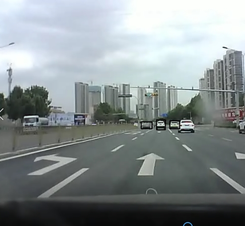

Now there is a condition, there are several standing cars in the front  of the radar, which are close to each other less than 2m, as belows in the picture:
In this situation, the values of the three parameters is not suitable,in this  condition,how should I select the value of those parameters?

    That is a difficult problem for the SRR demo, primarily because of the poor angular resolution, and poor range resolution of the SRR chirp design (~0.6 meters).
    I'd recommend that you modify the SRR demo to have the USRR frame enabled (It has a resolution of ~0.04 meters). You can also modify the tracker to track the USRR targets (not present in USRR). This way stationary objects close to the car are tracked separately.
    There is another (more advanced) tracker available in the  traffic monitoring lab in the industrial toolbox. You can try incorporating that into the SRR. The advantage of that tracker is that it will hold on to moving objects that become stationary.
