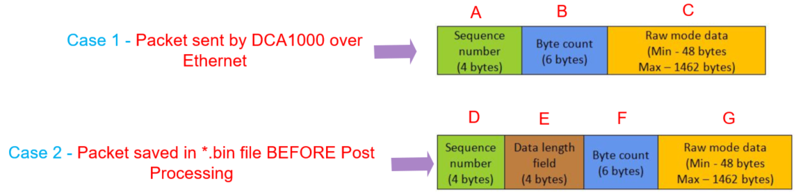

I have been reading quite a few threads on the ADC data related topics and I need some clarification on the raw ADC data format as sent over ethernet and saved as *.bin file BEFORE the post processing. Below is the diagram I prepared for clarification and following are my questions:
1 - In Case 1, does field B give the number of bytes in field C?
2 - In Case 2, does field E give the sum of number of bytes in fields F and field G?
3 - I read in one of the posts that field F actually gives the number of raw mode data bytes received UNTIL that packet (but excluding raw mode data in that packet). If that is correct, field E should give the number of bytes in field G. Can you please confirm? (Also, if this is the case, does field E give the total number of bytes in fields F and G?)
4 - If there are other details I should keep in mind regarding these packet formats, can you please comment?
Thank you for your help.
Cagri
  • Hello Cagri,
    mmWave Studio provides the DCA1000 CLI source code which captures the raw data over ethernet and stores to a *.bin file.
    You can refer this code for further detail to find how data format is used within it.
    C:\ti\mmwave_studio_02_01_00_00\mmWaveStudio\ReferenceCode\DCA1000
    Jitendra
  • Hi Jitendra,
    I had a look at the code.
    I was able to confirm my question related to Case 1 based on the information in the code. However, for Case 2, the code is pretty difficult to follow to get a straight answer. There are no comments in the code to assist the reader either and therefore following offsets and pointers between multiple functions and conditional statements turned out to be a loss of time.
    I will reverse engineer the output file, which will take less time.
    Cagri
    P.S. In Case 1, there seems to be discrepancies between the #defines for total read buffer size (i.e. 1470 bytes) versus the documentation (i.e. 1472 bytes)
