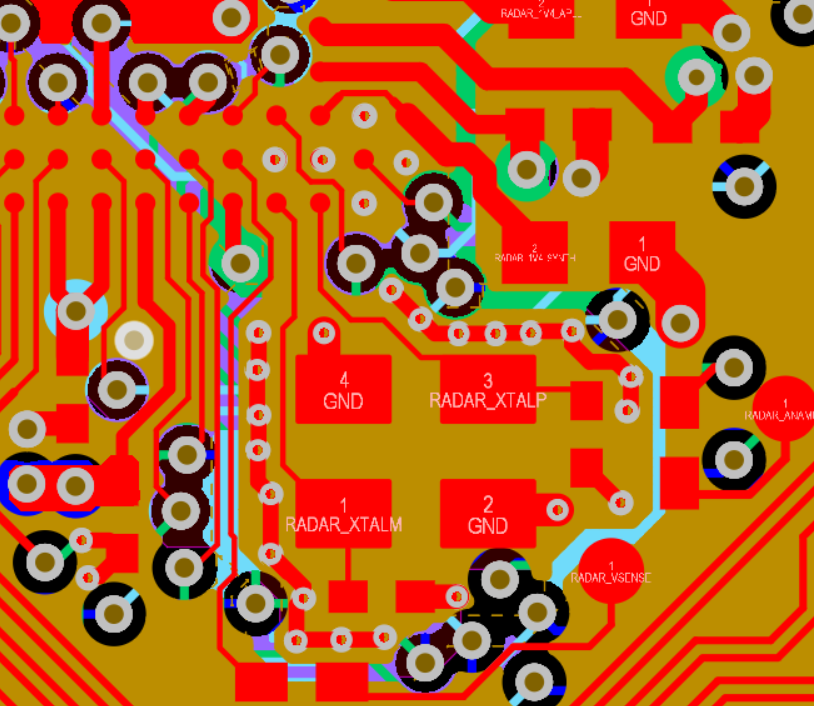

hi. this is jiyoung
and currently i'm making RADAR PCB using IWR6843.
see the reference model which is given by TI.
i have some questions.
from the reference design,
the microvias connect 1-2 in the RF part
and there are additional vias to connect L1-L4-L6, but there are just a few and the number of them is 7
i think it's because there are some components are located at the bottom side of PCB.
if there aren't any component and there are many empty spaces, is it better to have 1-8 additional vias as many as possible?
this is my first questions
and my second questions is
from the reference design, second layer is separated into two GND planes.
i think the reason why doing this is be cautious about PWR, DIGITAL noise which can disturb the RF signals
but what about the crystal noise? crystal and RF grounds are connected from the reference design.
is the crystal noise is so higher(25MHz) than IF frequencies so do you think it is unnecessary to consider the noise from crystal?
if there are any considerations or explanations about designing RF PCBs,
please let me know.
i already have a "HardwareDesignCheckList_Vp08_IWR6843"
look forward your reply
thank you:)

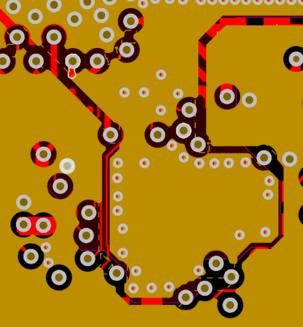

    Second question: Very good question!.
    We do add via fence around the crystal (not ideal though!), as shown below in the layout image.
    And in the 2nd Layer a cut out is done as shown below.
    Crystal circuit refereed to RF ground.  Crystal is not an aggressor, rather it's victim of other signals coupling to crystal pins, Crystal pins CLKP and CLKM are high impedance nodes, which are susceptible for aggressor in the design (Such as PMIC switching nodes, LVDS clocks etc). Hence it's need to shielded, However care need to be taken during  the shielding not to add additional parasitic which will disturb the crystal intentional capacitors.
