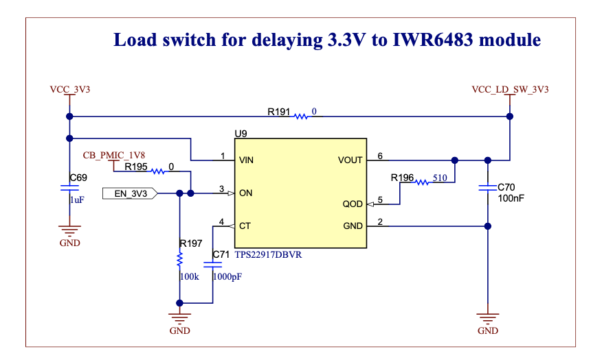

I'm just preparing a custom board with the AWR6843.
I designed it based on the reference design PROC073C. But I didn't understand the role of U9 (TPS22917DBVR). According to the notes in the schematic, this is Load switch for delaying 3.3V to IWR6483 module. But I didn't understand.
Looking forward to your answer.
