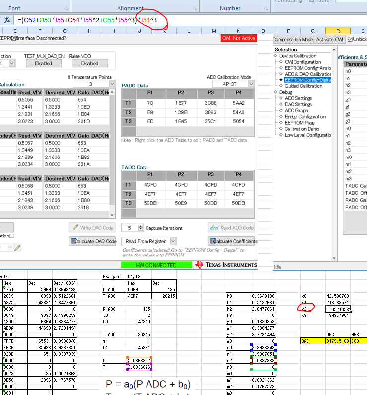

I have a question about equation which is used in PGA300 Device Calibration. I got a result as following Fig.1 and Fig.2 using by PGA300 and GUI. However, If I use following equation which is in PGA300 datasheet and calculate DAC value using these coefficients (h0, h1, ..., m2, m3), I can't identify these coefficient results are correct or not. Could you confirm a result of excel file? If this calculation is not correct, please give me some advice to correct this calculation.
Verification about equation.xlsx
