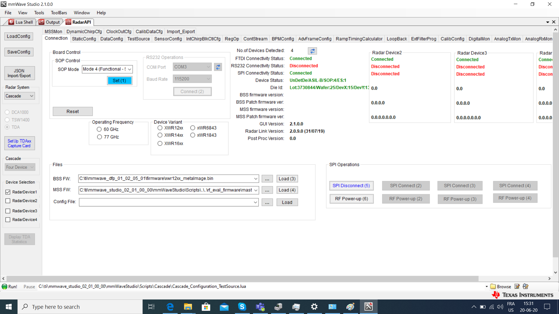

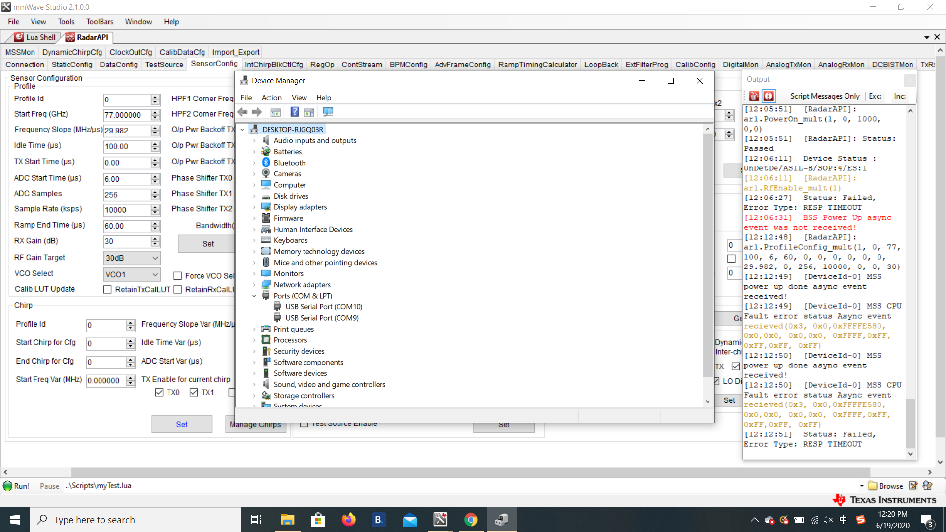

We have a problem of RS232 connectivity. We installed all the drivers in the manual and we saw the two PCB ports in the device manager (com10 and com9) in PC (as shown below).
The mmwave 2.1.0.0 didn't see RS232 connection (see below).

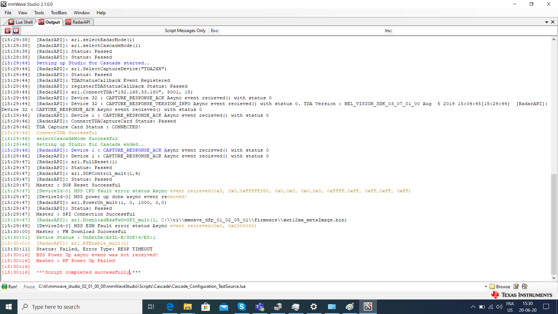

    Thank you for the support. It gave the same issue of Connectivity. When i run the “Cascade_Configuration_TestSource.lua", i have the same error message, please find the pictures attached.

    Other errors are solved by using the 2nd-generation firmware package (DFP) meta image 'xwr22xx_metaImage.bin' file in .Lua script.
    For the version of meta image, you need to read the marking on the chips (it should be xAWR2243P or equivalent for using 'xwr22xx_metaImage.bin' file).

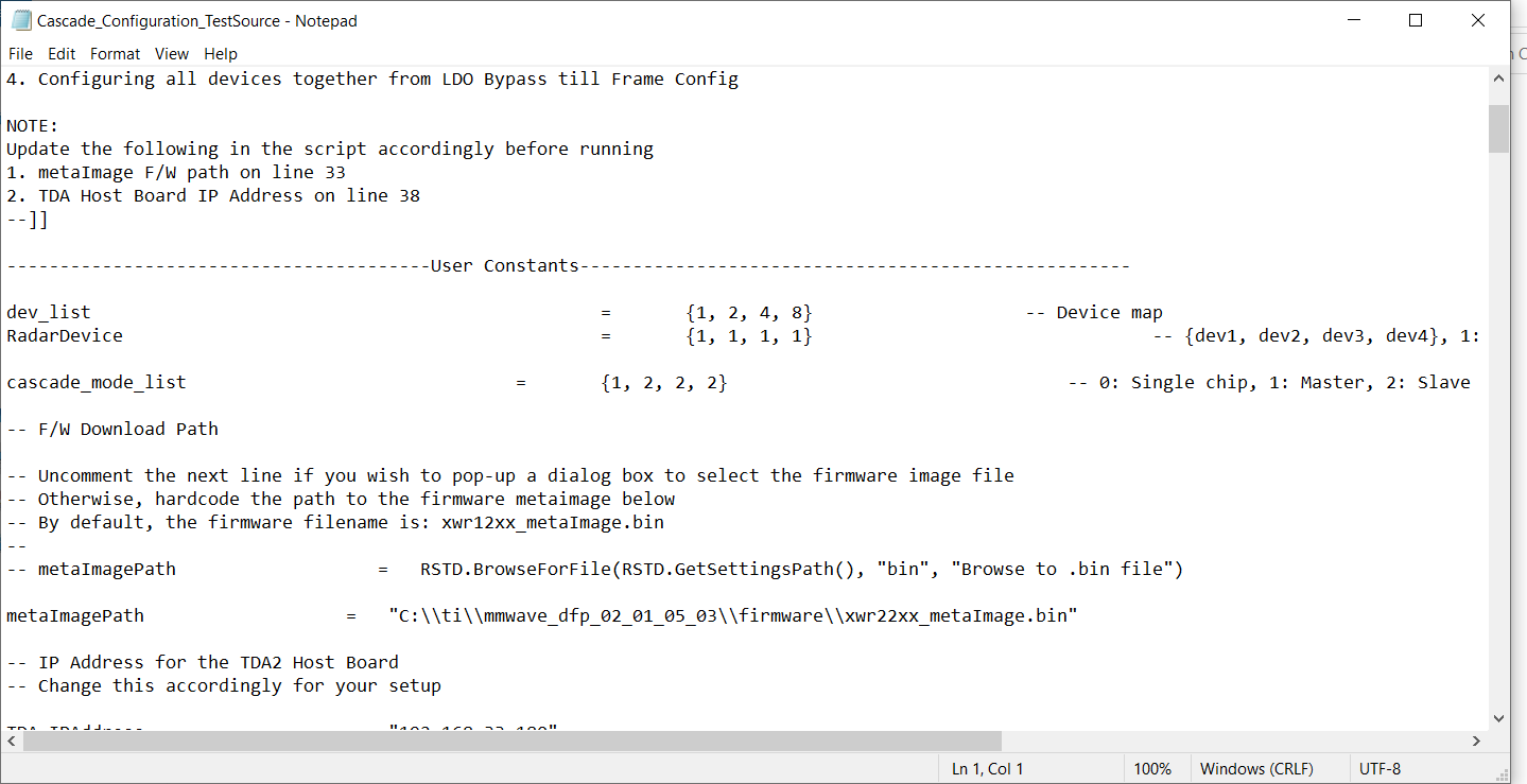

    Configuration of radar devices 2-4 manuelly is quite complex. The easiest way is to use .Lua scripte 'Cascade_Configuration_TestSource' which you can find in Cascade script.
    Please check the path of meta image Inside .Lua scripte, which it must be 'xwr22xx_metaImage.bin'. I attached where you need to modify and the expected working device interface.

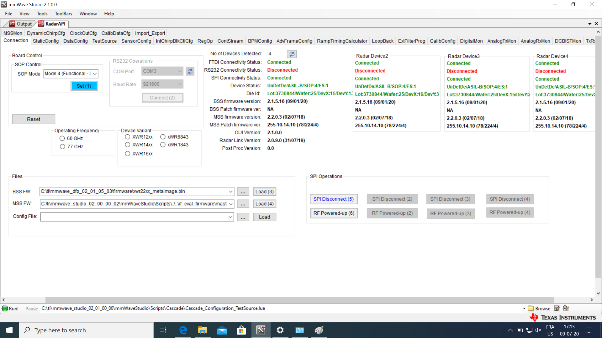

          I have  used .Lua scripte 'Cascade_Configuration_TestSource' and  checked the path of meta image Inside .Lua scripte. But the SPI  of radar devices 2-4  is  still showed 'Disconnected'.
     When  I click on “TDAxx ARM” with any one of the device selected, the output still presents 'Frame Periodicity Response from Capture Card time out !!'  It seems  no difference  afrer loading  the  **.lua scripte.   I havenot changed the IP Address for the TDA2 Host Board.  Is it necessary ?
    SPI must be connected to be able to capture data, please find the hardware connected statues. You can check manuelly SPI connection. The
    IP address is 192.168.33.180, which different from the static Ethernet IP address 192.168.33.30.

    The mmWave Studio tool does not use a UART/RS232 connection for mastering the AWR devices on the MMWCAS-RF-EVM. So the status of RS232 being disconnected is normal for MMWCAS-RF-EVM operation.
    The mmWave Studio tool connectivity is only between the MMWCAS-DSP-EVM and host PC over Ethernet. The TDA2 host processor on the MMWCAS-DSP-EVM runs an application which acts as a bridge between the mmWave Studio Ethernet connection and 2 SPI ports on the TDA2. The TDA2 directly masters the 4 AWR devices over these SPI ports.
    I hope that helps.
