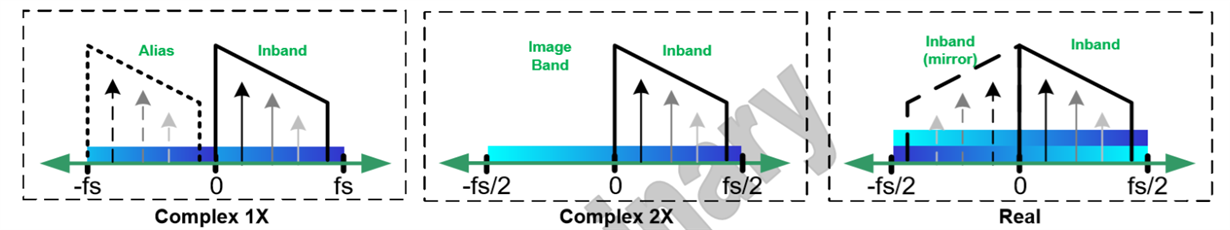

IWR6843ISK: Difference between real mode and complex1x
Part Number: IWR1843
In a previous post, inside related discussion linked with this thread,  @ mentionned that : "Complex 1x mode, Only Real IF Spectrum is filtered and sent to ADC, so If Sampling rate is X, ADC data would include frequency spectrum from 0 to X."
But if that's true what's the difference between Complex1x mode en real one ?
thanks,
Vincent

  • Hello, yes i read a bunch of time this doc , but this pdf explqin the difference between real (I-only) ADC output and complex output. But doesn't explain the difference between complex1x and complex2x
    And when you try to understand this difference you find this post  but reading this post and especialy the answer of @
    the difference between complex1x and real become blurred
    ADC Digital front-end supports three output modes 1) Complex 1x 2)Complex 2x 3) Real output modes
    Complex 1x: The default mode being complex base-band output.
    In complex 1x, produce the optimal output sampling rate (i.e., output sampling rate fs = fb,max/0.9, fb is the baseband interest), which achieves the best noise figure and lowest (optimal) output sampling rate. In complex 1x case image band is not available, However image band is suppressed using anti aliasing filter and frequency is shifted such that 0 to fs frequency components are sent out.
    Complex 2x:
    An alternate mode being complex baseband output at 2X the optimal rate (i.e., fs = 2fb,max/0.9), which can be used if both inband and image band visibility is desired at the final output.  The in-band noise figure in this mode is identical to the default Complex 1X configuration.
    In this mode, In-band and the image band being visible at the final output, and since the image band is kept as alias-free as the in-band, image band monitoring can be used for purposes such as interference detection, etc.
    Real output mode:
    In this configuration, the receiver is operated in real-only mode. Real output at fs = 2fb,max/0.9, which can be used if real-only analog chain is desired, for low power operation.Thus, the Q-channel IF, ADC and decimation chain are unused, and hence the noise figure is poorer compared to the complex baseband configurations.
