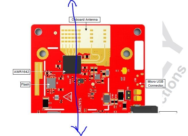

I am using the AWR1642 Boost in an experiment to determine the change in the reflectivity ity (with time) of partially reflective surfaces  along the longitudinal direction of an object in front of the radar. I am using an Ultra Short Range Configuration with a Range  resolution of about 5cm .I am able to get results (laterally  across the outer surface  but not no inner measurement. I am expecting losses so I have varied with the detection threshold  but still  unable to  get the resolution  in the longitudinal direction. The object is stationary and only ten (10) inches from the device so I thought the power should be enough.. I am wondering if anyone has tried an experiment like this and what can I do to get the results in the longitudinal (axial)l direction. I am looking at both the scatter and the range plots
  • Hello Lincoln,
    By longitudinal direction do you mean In the direction along the blue line shown in the below figure?
    The antennas on the 1642boost are all aligned in the azimuth plan, so there is no angle measurement possible  on the elevation plan (in the direction of the blue line). So all the objects in that plan will show up at 0deg elevation itself. In the 1843boost , which has 3 Tx antennas, there is one Tx antenna that is design for elevation plan, so you get some angle on the elevation plan too.
