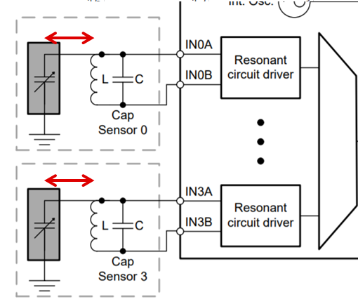

My customer considers to use LDC2x1x family for proximity detection and provided a question.
How long trace/cable is allowed between sensor plate and LC tank?

What kind of cable is customer planning to use? Is it a trace on PCB or just a wire connection between the device and the sensor plate? In any case, the inductance and capacitance should not exceed to maximum allowed values. It is a good idea to test the setup with the EVM to make sure that the results are acceptable.
