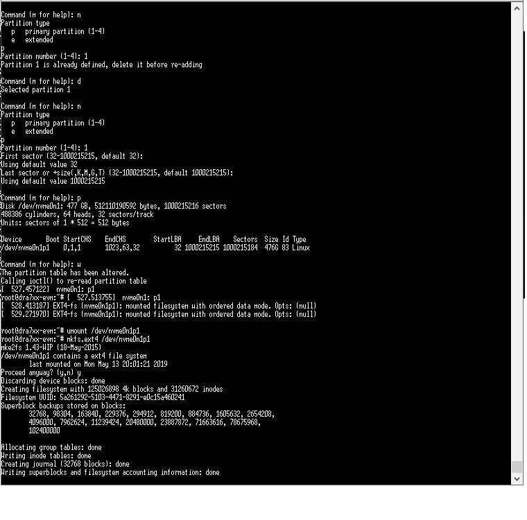

-Formatting the SSD
-Run the following command to confirm if the formatting operations is successful or not. It should show an entry named “/dev/nvme0n1p1” (as shown below) in case of successful formatting.

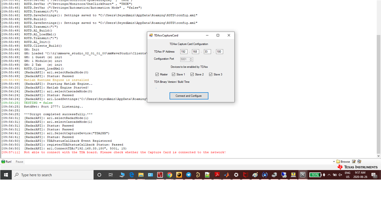

- Then I tried to configure the TDA using mmwaveStudio :
the issue is , I cant connect to the TDA board by clicking the "connect and configure" bottom

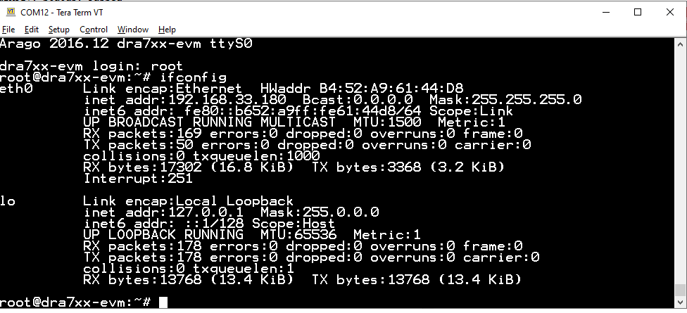

I used teraterm to check the network using ifconfig command:
I am not sure if I missed any steps to make a proper connection or not.

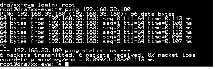

    a. Check the Ethernet cable connection, LED status on TDA2xx Ethernet port connection. Confirmed
    b. Ensure the PC IP address to be the same as mentioned in the Section 7.3.1. confirmed
     Try to ping TDA2XX IP address from PC to verify if the network connection is proper. confirmed

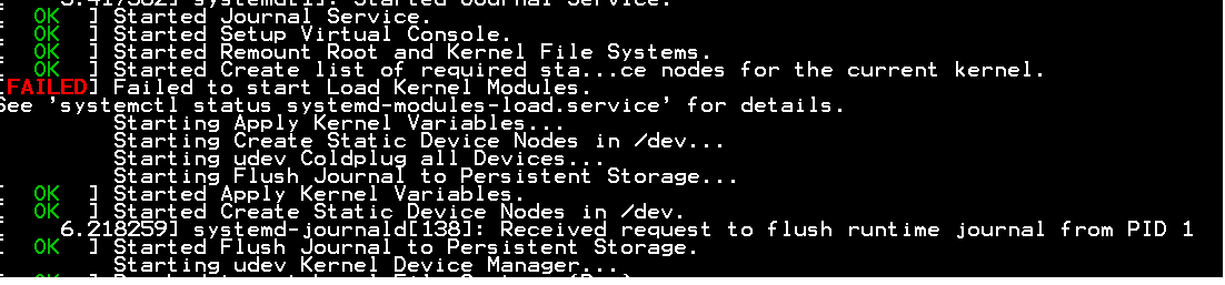

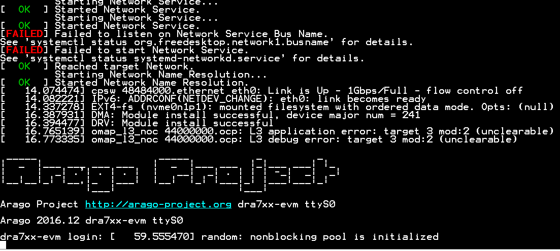

    c. Check the terminal screen if it had any error message while booting up.
    These are the errors I am getting by rebooting the board
     If yes, then try to reboot. , I did but getting the same errors
     Flash the SD card again if the error persists., I did but getting the same error
