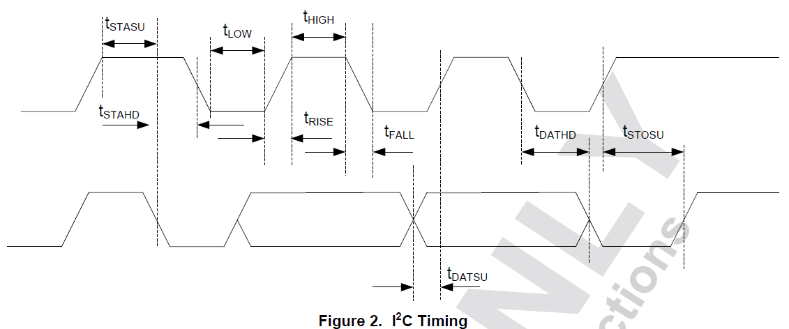

    I'm curious why you say the GUI cannot be used. Using the GUI is the simplest method to communicate with the PGA302. If you would like to use a separate MCU to communicate with the PGA302, the I2C timing requirements are here:
    Pull-Up Voltage = 1.8V, Capacitance Load on Pin = 100pF, Pull-Up Resistor= 1.3KΩ
    VIH High-level input voltage min 0.7*DVDD V
    VIL Low-level input voltage max 0.3*DVDD V
    VOL Low-level output voltage max 0.4 V
    fSCL SCL clock frequency if M0 frequency is 1MHz  max 800 KBPS
    if M0 frequency is >1MHz max 1000 KBPS
    tSTASU START condition set-up time min 260 ns
    tSTAHD START condition hold time min 260 ns
    tLOW SCL low time min 0.5 μs
    tHIGH SCL high time min 0.26 μs
    tRISE SCL and SDA rise time max 120 ns
    tFALL SCL and SDA fall time max 120 ns
    tDATSU Data setup time min 150 ns
    tDATHD Data hold time min 150 ns
    tSTOSU STOP condition set-up time min 260 ns
    tSTOSTA Time from STOP condition to new START condition At 100KPBS min 4.7 μs
    A description of the command and receive packets for I2C communication with the PGA302 is located in the I2C interface section of the datasheet.

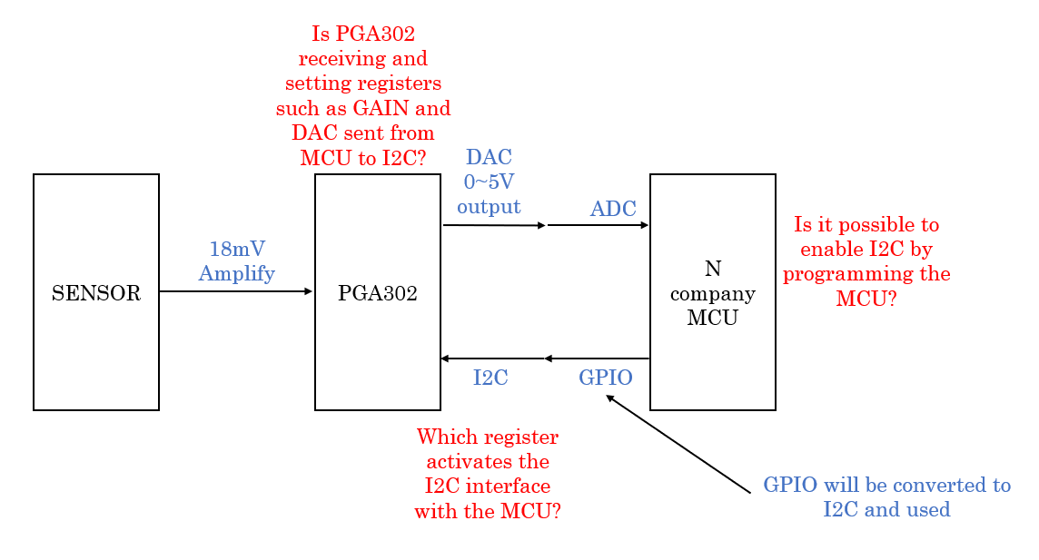

  • Thank you for answering the question.
    I have N company's MCU, so I have no choice but to use this product.
    The reason I can't use the GUI is that it's inconvenient to set up multiple products.
    There are additional inquiries.
    Please refer to the picture below.
    1) Is the MCU programmable with the PGA302 to set registers using the I2C interface? Should I use MSP430F5510?
    2) If the MCU sends data when the master PGA302 is the slave, can the PGA302 receive the data and set the register?
    3) If PGA302 is not the basic communication mode, how to activate I2C?
    please answer about my question.
    Thanks.

    In reply to your earlier questions.
    1. The PGA302 always acts as a slave device, and can be configured using any MCU that has I2C protocol functionality.
    2. Yes, the MCU can send commands to read or write to registers in the PGA302.
    3. The PGA302 has 2 modes of operation:
    1. running mode, where the digital interfaces (OWI and I2C) are not active, and the input signals is processed and a voltage output is produced by the DAC
    2. reset mode, where the digital interfaces are active. to switch to reset mode from running mode, you send 0x03 to the micro_interface_Control register. Details of how to structure the I2C command to properly address each register are included in the I2C Interface section of the datasheet.
