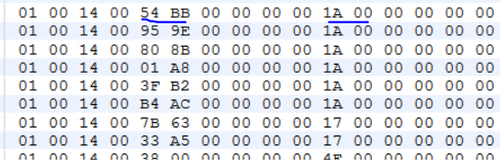

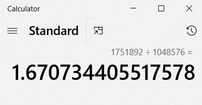

I am using High accuracy demo. I have converted the UART stream of Range Estimate and I am always getting a lower value compared to the value being shown in the High Accuracy Visualizer. When the real reading is about 2.24m, I am getting 1.66m. Is there a multiplier for the visualizer. I have earlier used IWR1443 and IWR1642 both didnt have any multipliers.
