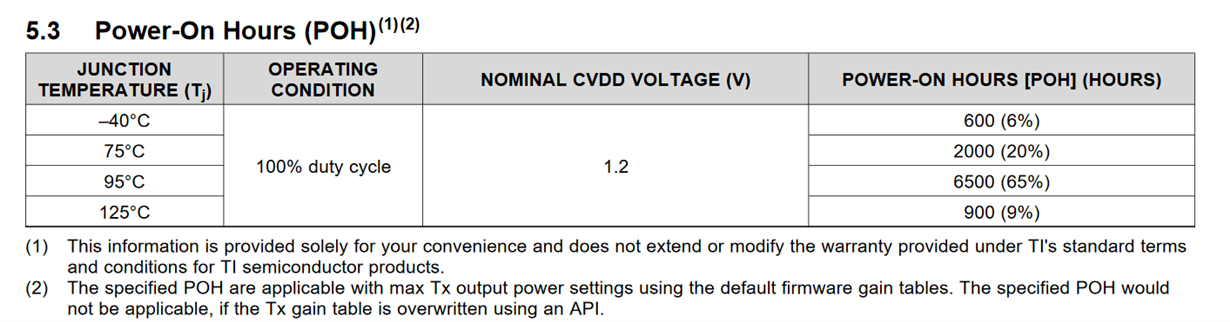

The AWR2243 and AWR1843 datasheets both specify POH as the following:
1. Is 100% duty cycle defined as continuous-wave transmission (i.e. no chirp idle time)?
2. What kind of POH can we expect at 50% duty cycle for both AWR2243 and AWR1843 (accounting for chirp idle time)?
3. Is it correct that the IC has lower lifetime at 75C Tj compared to 95C Tj?
4. What is the degradation criteria that limits POH? Will the chip still function with degraded performance (e.g. SNR, TX power, etc)?

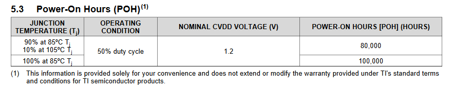

5. For comparison, IWR1642 specifies 50% duty cycle POH as the following (100,000 hours at 50% duty cycle, 85C Tj). Is this performance representative of other TI radar sensors with the same 45nm RFCMOS technology?
    <VD> That is correct. This assumes the active chirp time alone.
    <VD> With 50% duty cycle the POH will double since at this point it is limited by the analog/RF turn on time.
    <VD> The table does not indicate a life time at a specific temperature. It represents a usage profile across the whole -40C to 125C temperature range. The usage assumes 6% usage at -40C , 20% at 75C, 60% at 95C and 9% at 125C. In general more usage at higher temperature will reduce the POH.
    <VD> The transister FIT (Failure in time) analyses govern the POH. The exact type of failure cannot be predicted.
    <VD> yes, this is same 45nm RFCMOS technology.
