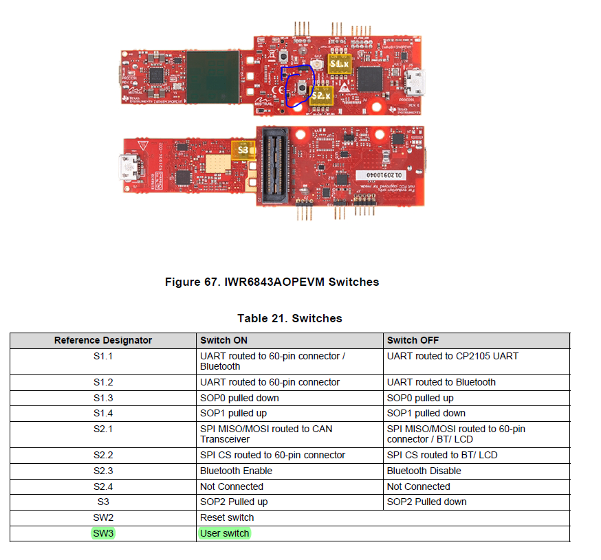

we are evaluating the schematic of AOPEVM Rev.F board, and would like to know what's the function of SW3 (User switch) from AOP EVM as below screenshot.Thanks!

It's the general purpose push button switch given to the user/developer to develop applications. You could use this switch in your user application to take the input from external interface and could act on it based on your application needs.
