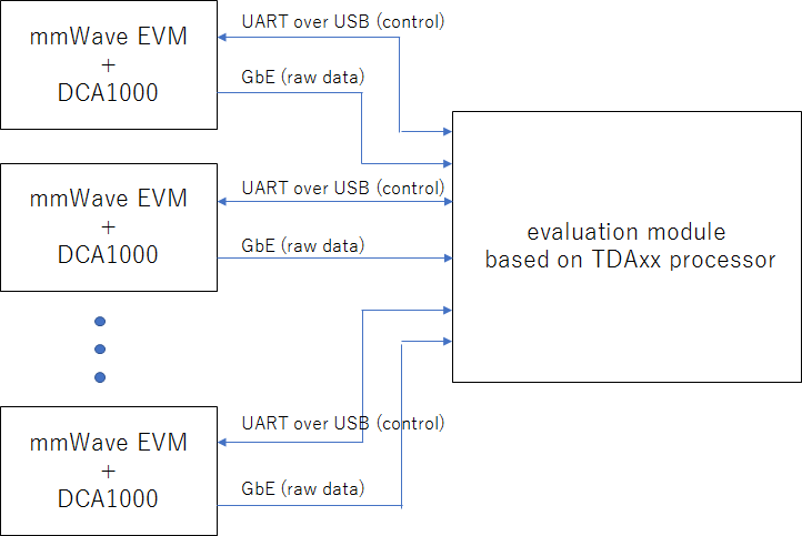

We are looking for an evaluation module for an Automotive processor that can control multiple radar modules via USB(UART) and processes raw data sent via Gigabit Ethernet.
We assume as the radar module the following:
   TI mmWave Sensor EVM(such as AWR2243 EVM) + DCA1000EVM
It seems that some of them are introduced on the following website, but I don't understand yet if there is one that meets our requirements.
Therefore, I would like to introduce if there is an evaluation kit that can control multiple RADAR EVM+DCA1000EVM and process multiple raw data via GbE.
https://www.ti.com/processors/automotive-processors/tdax-adas-socs/design-development.html
Masashi

    With Multiple radar modules do you mean: cascade (all sensors together) or satellite mode (scattered across the places)?
    Jitendra
    I mean satellite mode in this case, something like this,
    |                                            | <--------UART over USB (control)-------
    | mmWave EVM+DCA1000 | -----------GbE (raw data) -------------      |
    |                                            | <--------UART over USB (control)------->    |                                                                             |
    | mmWave EVM+DCA1000 | -----------GbE (raw data) ------------------->   |   evaluation module based on TDAxx processor |
    |                                            | <--------UART over USB (control)---|    |
    | mmWave EVM+DCA1000 | -----------GbE (raw data) -------------------|
    Are there any solutions, that is an evaluation module based on TDAxx processor match the above requirement?
    Masashi
  • I have added figure(rough diagram) because the diagram above is cluttered.
    For this you need to control multiple DCA1000 having different Static IP address.
    Default DCA1000 support fix static IP address and Port.
    I would suggest to go over the DCA1000 doc and source code available in the mmWave Studio installation.
    <mmwave studio installation path>\mmwaveStudio\postproc\DCA1000EVM_CLI_Control.exe, DCA1000EVM_CLI_Record.exe
    Please refer TI_DCA1000EVM_CLI_Software_DeveloperGuide.pdf, TI_DCA1000EVM_CLI_Software_UserGuide.pdf from <studio install>\mmWaveStudio\ReferenceCode\DCA1000\Docs
    And source code mmWaveStudio\ReferenceCode\DCA1000\SourceCode
    DCA1000 requires an Ethernet Command sequence to configure and trigger the capture which you can send from TDAxx processor.
    Jitendra
