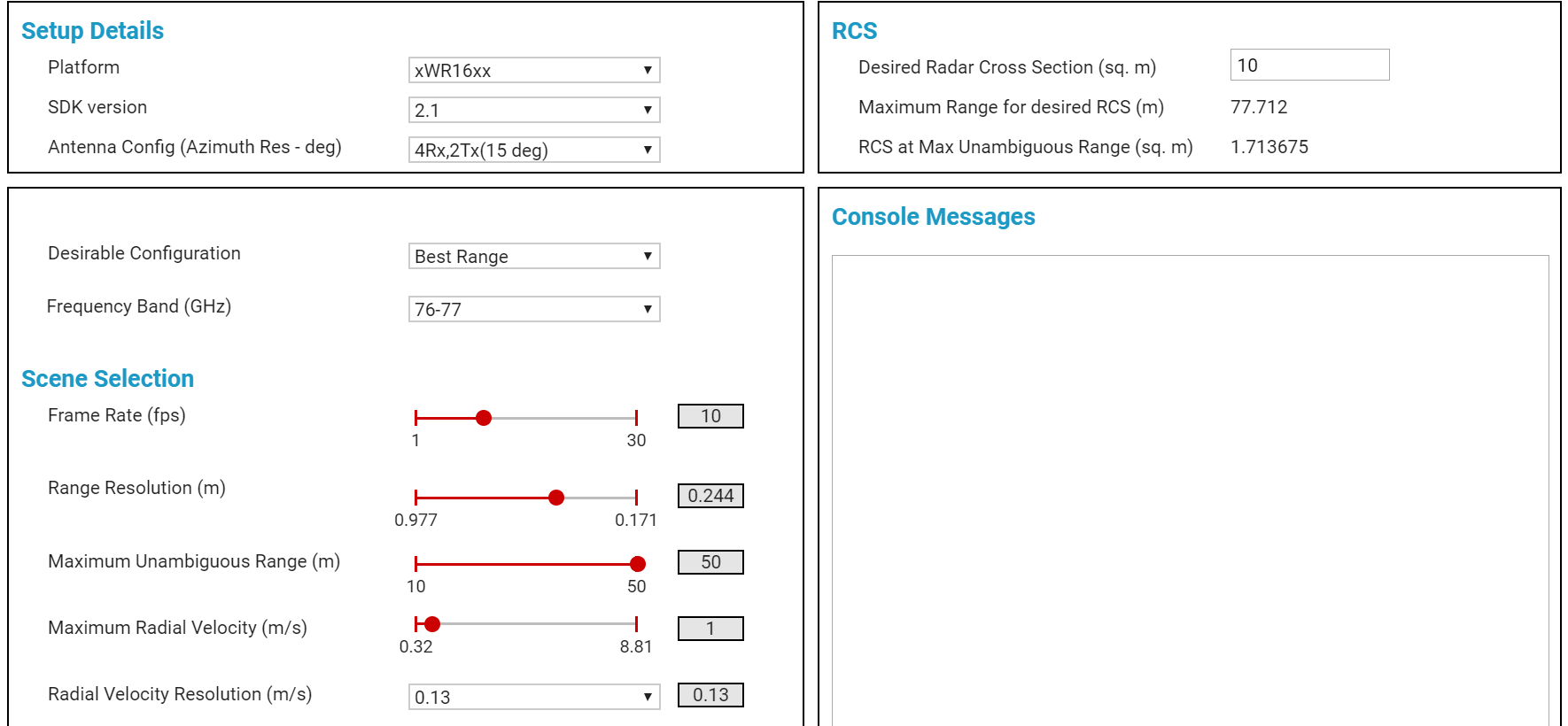

In the Demo Visualizer 2.1, when I set the desired configuration with the "RCS" of my target, "Desirable configuration", etc. the plateform give me a estimation of maximum range for the desired RCS. Can I have the formula that you use to calculate this value (maybe a modified Radar equation formula ???)
Thanks in advance.
  • HI, Jean:
    Below is the relationship between SNR and max distance (R).   IF you set SNR = minimum detectable SNR + system loss, you can derived the max distance R.  There is some assumption used for minumum SNR and system loss that is documented in the users guide for sensor estimation (click on help and then users guide).
    •SNR of the ADC sample is related to the transmit power, propagation loss, RCS of the target and thermal noise level in the received chain and the ADC sampling rate.
    •After 1D FFT, there will be processing gain from range FFT.
    •After 2D FFT, there will be processing gain from Doppler FFT
    •At the end, the SNR of the whole system can be listed as
    SNR=((RCS ×(P_t * G_tx * G_rx λ^2)/((4π)^3*R^4 ))×T_s)/(0.9k_B T_0 N_F )×N_adc×N_(chirp_loops)x N_ant
    Where Pt is the transmit power; Gtx is the transmit antenna gain; Grx is the receive antenna gain; λ is wavelength; R is the target distance; the KB is the Boltzmann constant equal to 1.38x10-23 J/K, T0 is the absolute ambient temperature in K; NF is the noise figure; Ts the ADC sample duration, Nadc is the number of ADC samples per chirp. Nchirp_loops is the number of chirp per frame; Nant is the total number of visual antennas.
