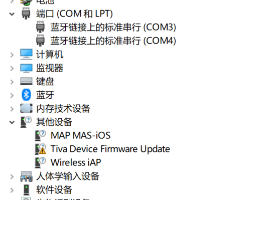

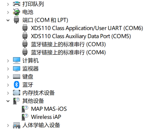

I used a AWR1642BOOST board, I have test the board with CCS and the demo, all going well, but when I change the board to another laptop, it cannot work.
I checked the board as if the xds110 cannot work, the board cannot gointo the DFU mode anyway:
I used xdsdfu -e

When I used xdsdfu -m to change to the DFU mode, it changed to Tiva device firmware update:
d:\ti\ccsv8\ccs_base\common\uscif\xds110>xdsdfu -m
USB Device Firmware Upgrade Utility
Copyright (c) 2008-2019 Texas Instruments Incorporated. All rights reserved.
Scanning USB buses for supported XDS110 devices...
<<<< Device 0 >>>>
VID: 0x0451 PID: 0xbef3
Device Name: XDS110 Embed with CMSIS-DAP
Version: 2.3.0.14
Manufacturer: Texas Instruments
Serial Num: R0041027
Mode: Runtime
Configuration: Standard
Switching device into DFU mode.
I try to connect the pin97 to GND and power cycle the board as the troubleshooting said, it cannot be change to DFU mode.
