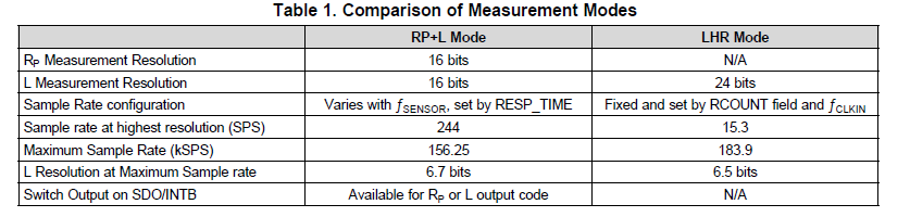

When using the LDC1101; does the Rp resolution change with sample rate in the same way that the L measurement in the RP+L measurement mode changes?
https://www.ti.com/lit/gpn/ldc1101
The table above gives Rp and L measurement resolutions, but only an L resolution at maximum sample rate, does that imply that the Rp measurement resolution remains 16 bit (probably with increased noise) as sample interval goes down?
In the Rp calculation equation, it looks to be 16 bit independent on sample rate; which also jives with my understanding of how the internal circuitry would work, but I am not able to find anything explicitly detailing this.
