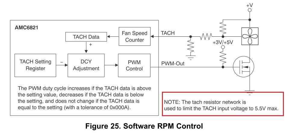

Please help to check customer question below. Thanks.
As I checked the DS and reference schematic, but I can’t calculate the appropriate voltage value for TACH input voltage limit to 5.5V max. Is it the resistor network be changed? Could you please guide me how to calculate it?
