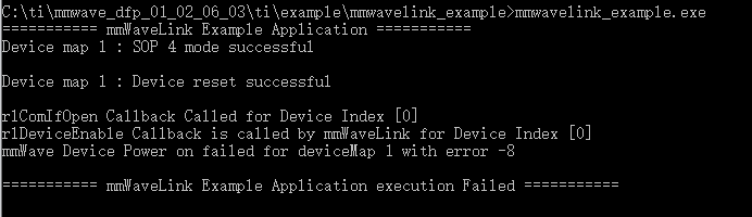

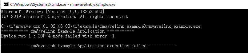

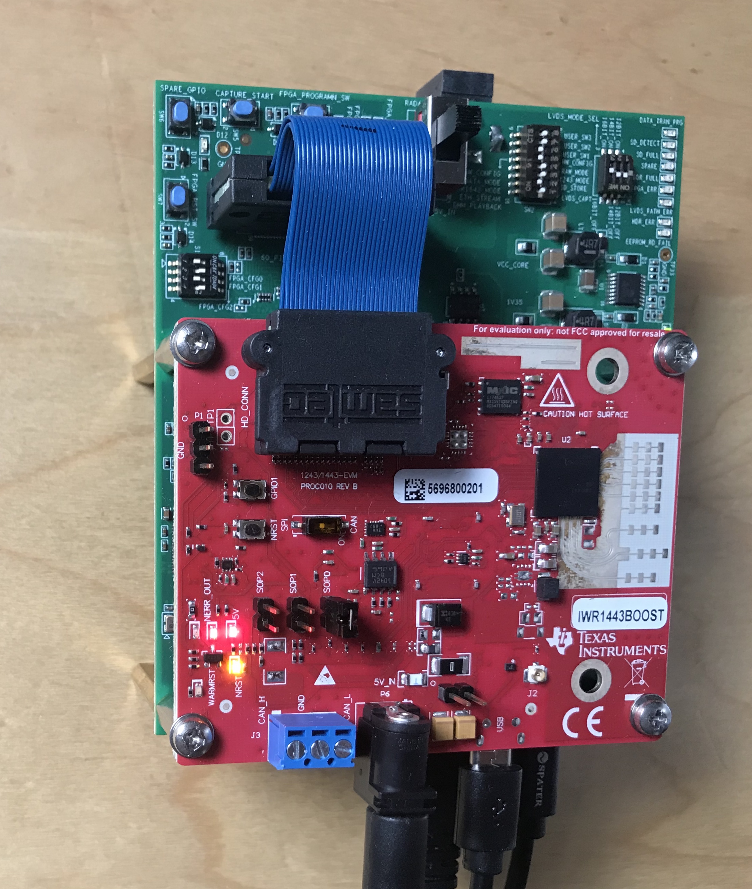

I was running the mmwavelink example code to test my newly received IWR1443BOOST. This example code was downloaded from the mmWave device firmware package (DFP).
I have followed the userguide as follows:
1. Connect IWR1443 ES 3.0 devpack and boosterpack to PC;
2. Erase sFlash before running this application;
3. Set the device in functional mode (only SOP0 is connected), and reboot the device;
4. Run mmwavelink_example.exe.
Here is the what the command window prints:
Did I miss any setup before running the application? Could anyone give any suggestions?
