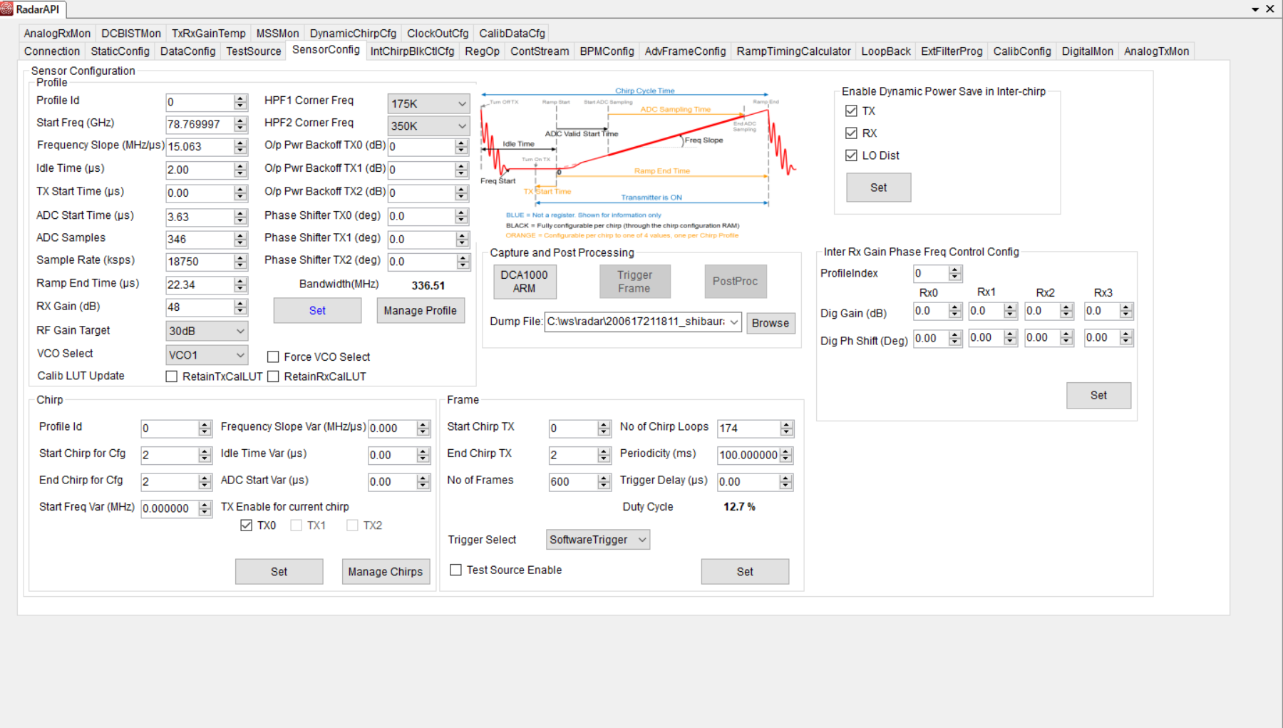

I use mmwavestudio1.0.
Since the Ethernet Packet Delay Theoretical Throughputis set to 25us, the theoretical maximum throughput is 325Mbps.
However, with the following chirp settings, data will be sent to the PC at 100 Mbps at first.
And  data will be sent to the PC  at 325 Mbps when chirp's transmission is completed
Is it possible to get throughput close to maximum from the beginning to speed up data extraction?
