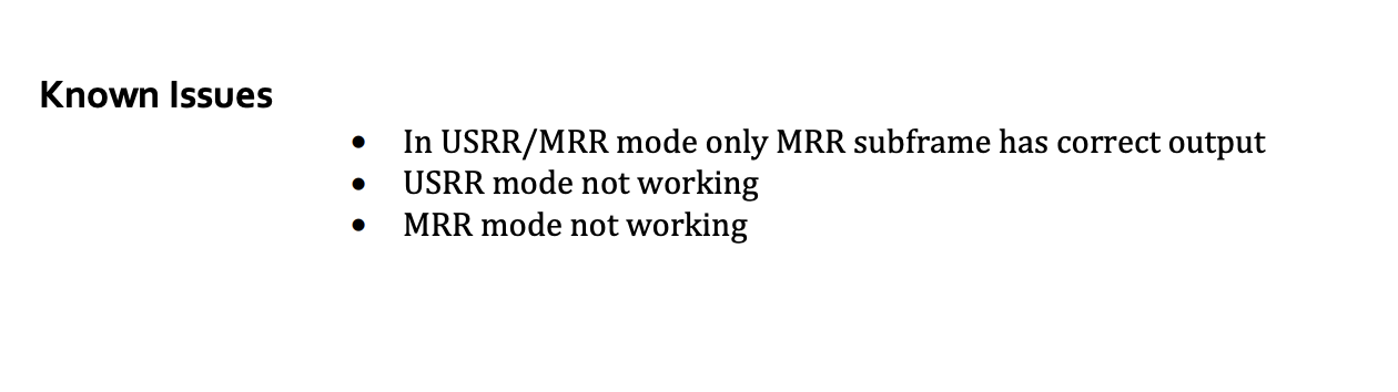

Hi Jitendra,
I want to know why the USRR mode and MRR mode cannot work.
And why only MRR has correct output in USRR/MRR mode?
BR,
Yunlong
Hello Yunlong,
MRR demo in TI-Rex Lab directory uses advframe config, where each alternate sub-frame is for MRR and USRR. Thus both of these features / modes are supported in MRR at alternate sub-frame
http://dev.ti.com/tirex/explore/node?node=ABwM-m2GR-WLXzg478tgow__AocYeEd__LATEST
Yunlong said:And why only MRR has correct output in USRR/MRR mode?
Let me know if I don't get your question correctly.
Jitendra
Hi Jitendra,
According to release note:
Can you explain it to me?
BR,
Yunlong
Hello Yunlong,
These are the limitations of the MRR Beamsteering lab. These limitations are due to the use of HWA for the USRR processing.
If the beam-steering and use of HWA are not required, then use the “MRR Lab7” for the developments.
Jitendra
