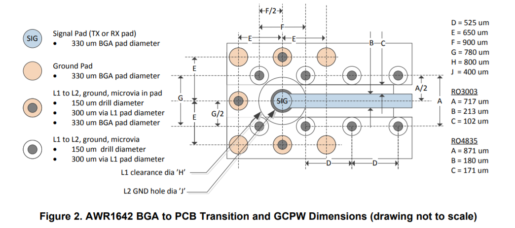

My customer is asking about antenna design for 60GHz
He refers to below document from Resource Explorer:
https://www.ti.com/lit/an/spracg5/spracg5.pdf
Below figure shows BGA to PCB transition based on AWR1642(77GHz).
Do we have similar information for 60GHz?
