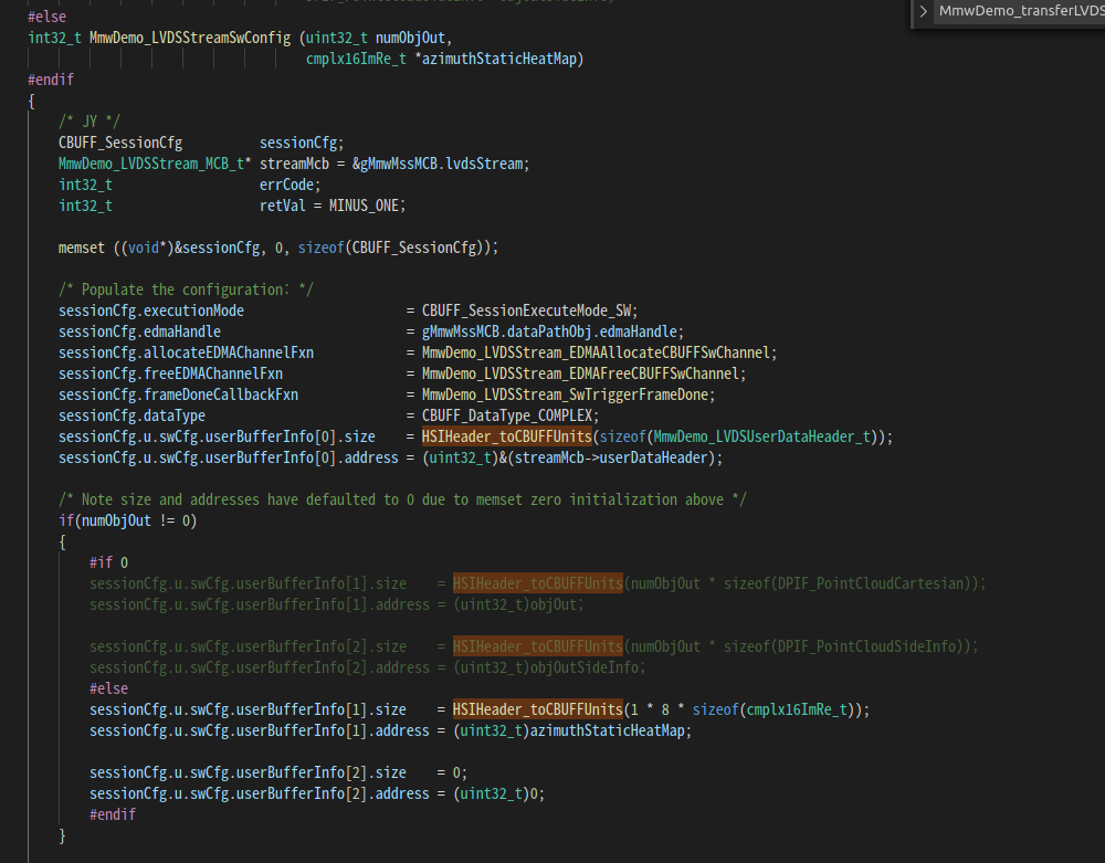

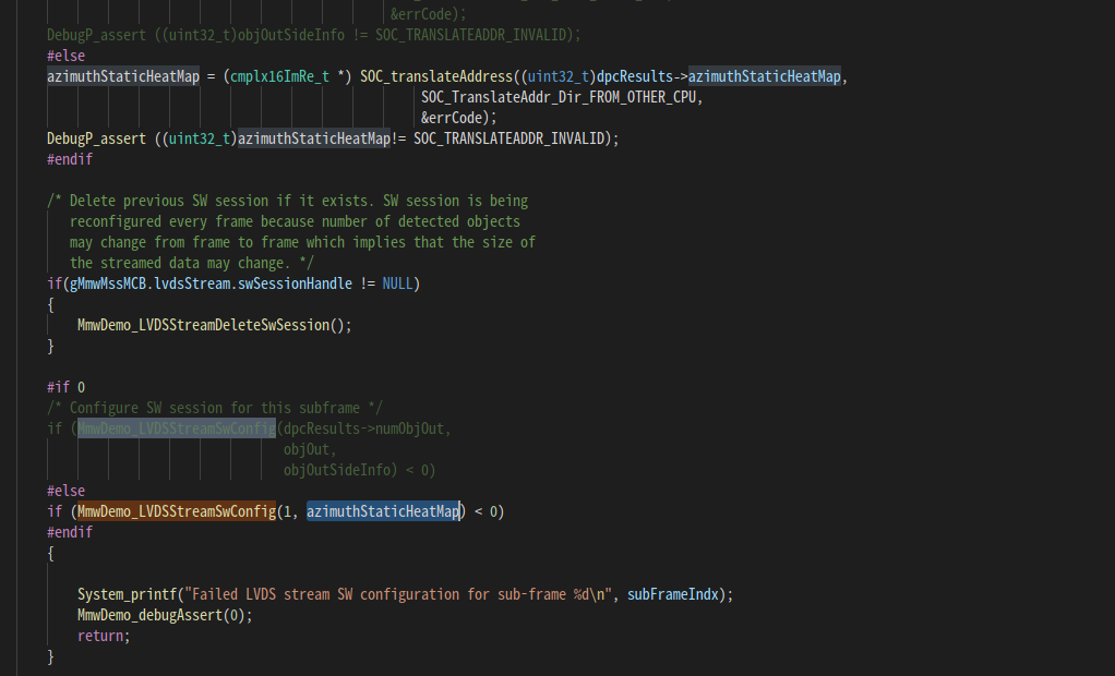

I want modify the application software transmit azimuth heat map over LVDS.
So I changed source code like this.
But there is no UTP response from sensor.
Is there anything I missed? Or could you recommend me something to refer how to modify LVDS user data?
