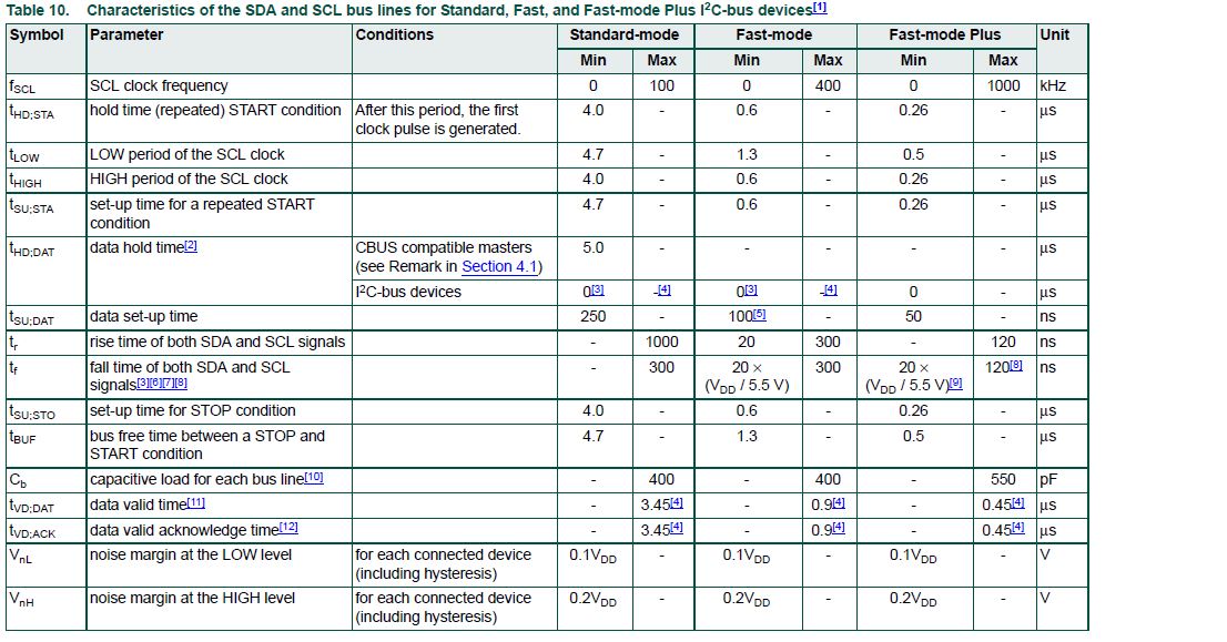

Hi TI,
Our system I2C operate in 100kHz, and we want to refer to the Standard mode (100kHz) as shown in the figure.
However, we found that the Timing of the datasheet seems Fast mode (400kHz) instead of Standard mode (100kHz).
Is there any concern that we just follow the Timing of the Standard mode (100kHz)?
Thank you!
