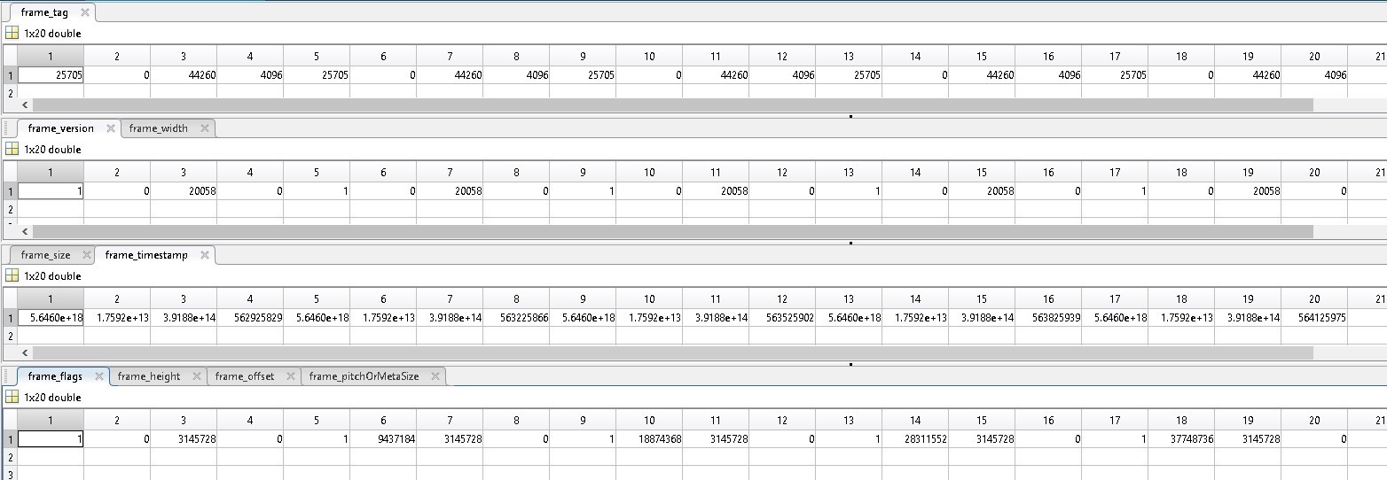

We carried out a data capture using the cascade radar with mmWave Studio and are trying to check the *_idx.bin files to see if there are any dropped frames - the file description in the 'getValidNumFrames.m' MATLAB script provided in the '4chip_cascade_MIMO_example' with mmWave Studio isn't very detailed but I guess the tag or timestamp should tell us this? We have tried reading the parameters from the file for each frame but they don't seem to make sense, as shown below, i.e. same 4 values just seem to repeat for timestamp/tag values. I have copied the MATLAB script we are using to read this below also, we read the parameters from first 24 bytes (which look more sensible, e.g. dataFileSize = 2.1454 GB, which is correct) and then loop through for 36 bytes for each frame.

pause on % to enable pause function
clear
clearvars -global
evalin('base','save(''myVars'')');
evalin('base','clear');
evalin('base','load(''myVars'')');
close all
clc
fileName = 'E:\Data_Captures\200708\200708_Capture_03\C1\master_0001_idx.bin';
idxFile = fopen(fileName,'r');
heaferInfoSize = 4;
heaferInfo = fread(idxFile, heaferInfoSize,'uint32');
tag = heaferInfo(1); % tag
version = heaferInfo(2); % version
flags = heaferInfo(3); % flags
numIdx = heaferInfo(4); % number of effective frames
fseek(idxFile, 16, 'bof');
dataFileSize = fread(idxFile, 1,'uint64');
read_position = 16;
len = 20;
frame_tag = zeros(1,len);
frame_version = zeros(1,len);
frame_flags = zeros(1,len);
frame_width = zeros(1,len);
frame_height = zeros(1,len);
frame_pitchOrMetaSize = zeros(1,len);
frame_size = zeros(1,len);
frame_timestamp = zeros(1,len);
frame_offset = zeros(1,len);
for i =1:len
read_position = read_position + 8;
fseek(idxFile, read_position, 'bof');
frame_tag(1,i) = fread(idxFile, 1, 'uint16');
read_position = read_position + 2;
frame_version(1,i) = fread(idxFile, 1, 'uint16');
frame_flags(1,i) = fread(idxFile, 1, 'uint32');
read_position = read_position + 4;
frame_width(1,i) = fread(idxFile, 1, 'uint16');
frame_height(1,i) = fread(idxFile, 1, 'uint16');
frame_pitchOrMetaSize(1,i) = fread(idxFile, 1, 'uint32');
frame_size(1,i) = fread(idxFile, 1, 'uint32');
frame_timestamp(1,i) = fread(idxFile, 1, 'uint64');
frame_offset(1,i) = fread(idxFile, 1, 'uint64');
end
