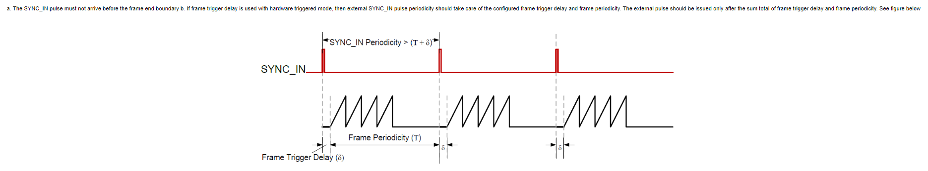

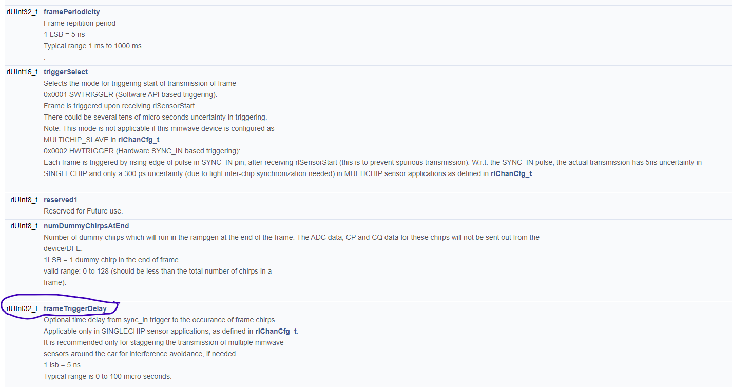

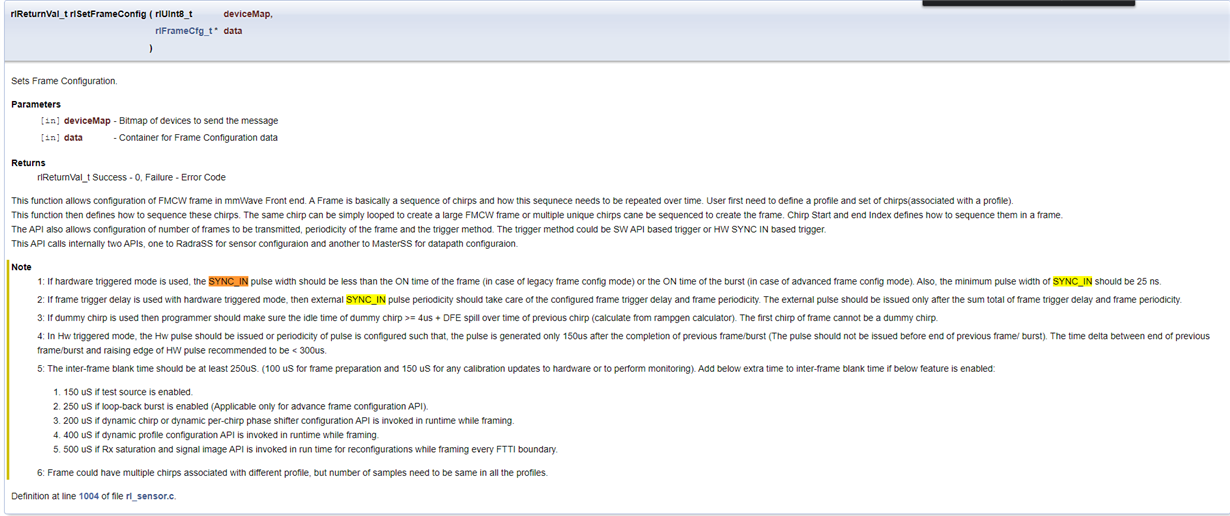

Is the IWR6843ISK Hardware Trigger mode edge triggered or level triggered? If it's edge triggered, is it rising or falling? If it's level triggered, how long after the rising edge is the first chirp emitted?
