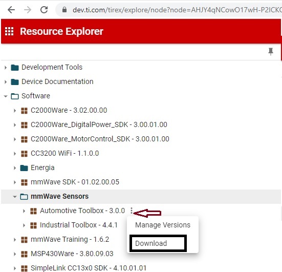

  • Thank you Jitehdra,
    This is all I see in TIREX:
    But when I download there is some project files, but no makefile etc to build?
    Is this correct? How do I compile the application in CCS?
    Brant
  • Hello Brant,
    I can't see your attached pictures.
    Try to download the TI-Rex Automotive toolbox.

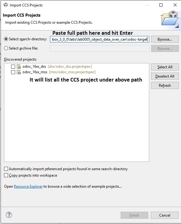

    Then in the PC, unzip and  go to : <path>\mmwave_automotive_toolbox_3_0_0\labs\lab0005_object_data_over_can\odoc-target   directory
    Copy this path and import this to ccs
    CCS Menu->Project->Import CCS projects;   paste above path an press enter to popup import window to import the projects.
    Please note that in the TI-rex CSS projects are provided in form of *.projectspec files( for MSS and DSS)
    Make sure that you have installed the required mmWave SDK version and other dependency tools and those are known to CCS; before importing above TI-Rex application.
