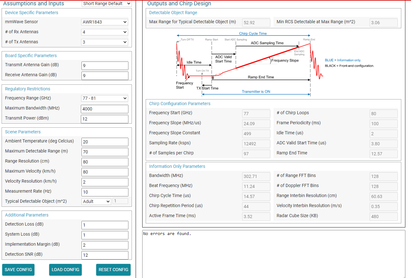

    I asked the question primarily because I re-checked some my configurations through TI sensing estimator and played a little in it.
    Can you explain why sensing estimator: for 70m and slope of 24.09 MHz/us says that maximum beat frequency allowed is 11.24 MHz (limit there is 0.9 * Fs as I can see)?
    (This actually mean if 70 m is mapped on 11.24MHz that our real maximum distance is lower and mapped to 10MHz)
    I suppose this is an error in sensing estimator. Could you just confirm my assumptions on this?

  • Hello Predrag,
    Sorry I somehow missed your response.
    Yes, there seems to be a formula error regarding this in the sensing estimator. Thanks for the feedback, I'll convey this to our internal team. To be sure on the maximum range, you can also calculate this yourself using the formula.
    There are various threads for this on the forum, and a document as well.
