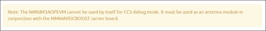

    It appears that you are trying to use the AOP EVM with CCS by itself, without mounting it on an MMWAVEICBOOST carrier card. Please note that MMWAVEICBOOST provides the XDS110 JTAG emulator, which is needed for CCS based development. This is also mentioned in the hardware requirements section of the corresponding demos in Industrial Tooolbox.
    You can follow the instructions provided on this page:
    Using CCS Debug for Development.
    From the same page:
    -Nitin
