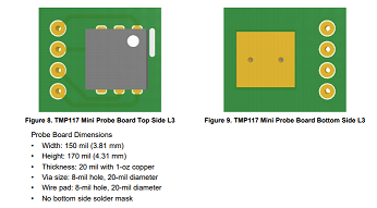

On page 18 of snia021b.pdf - section 2.2 TMP117 Mini Board. I'm looking to purchase or have a small run done of this Mini Board. I'm working with TMP117s to be used in a Covid-19 project.
Do you know where I can find out more information about this board? Design files etc., anything would be helpful.

    The design files for this coupon board don't appear to have been preserved, but there seems to be enough information in the application report to recreate this design if you wanted to.
    Alternatively, we do have a breakout board at the end of the TMP117EVM that you could use for basic testing.
