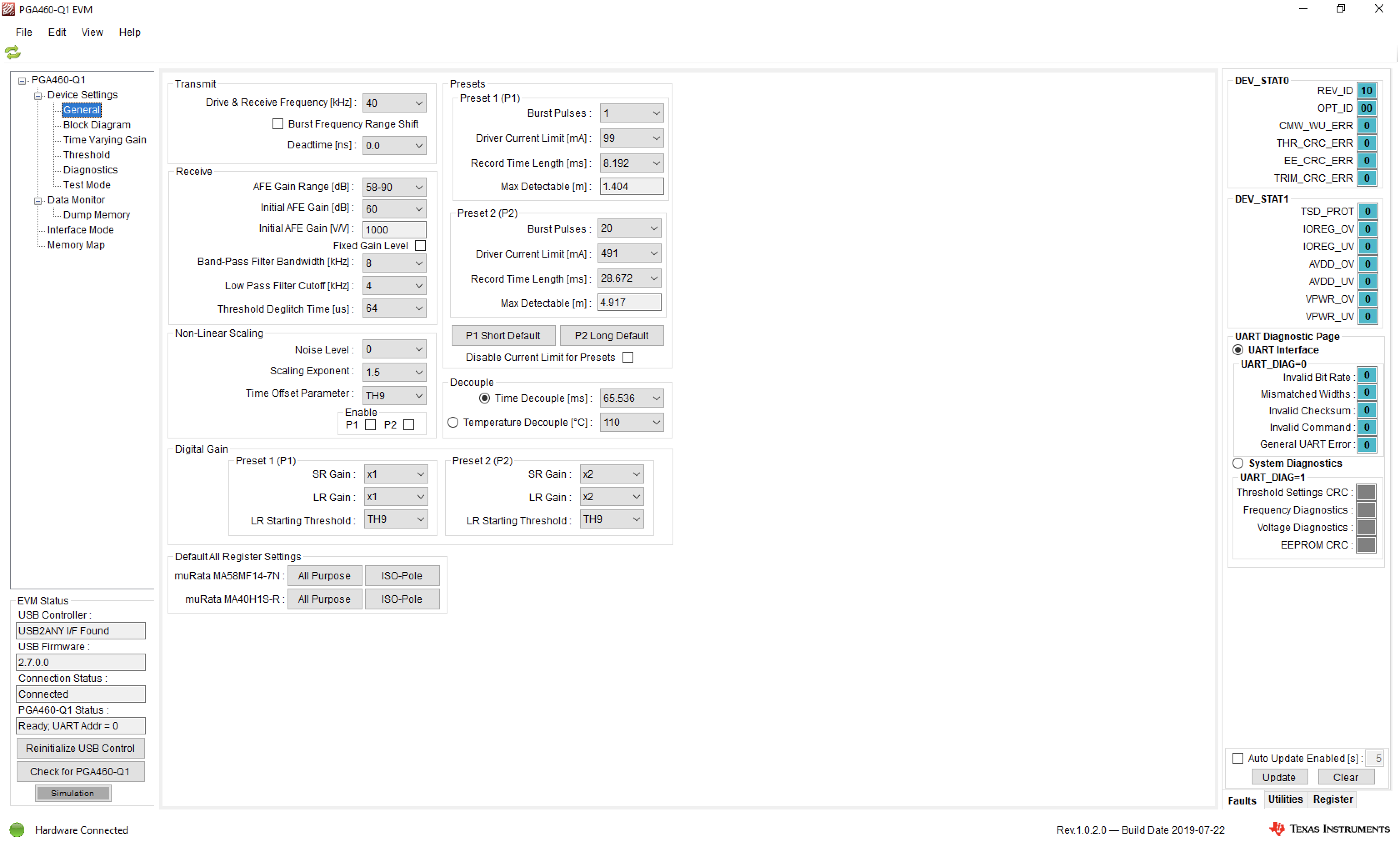

I have the PGA460PSM-EVM connected to the BoostXL board via UART and am testing with the GUI software. I am using an external 9V power supply.

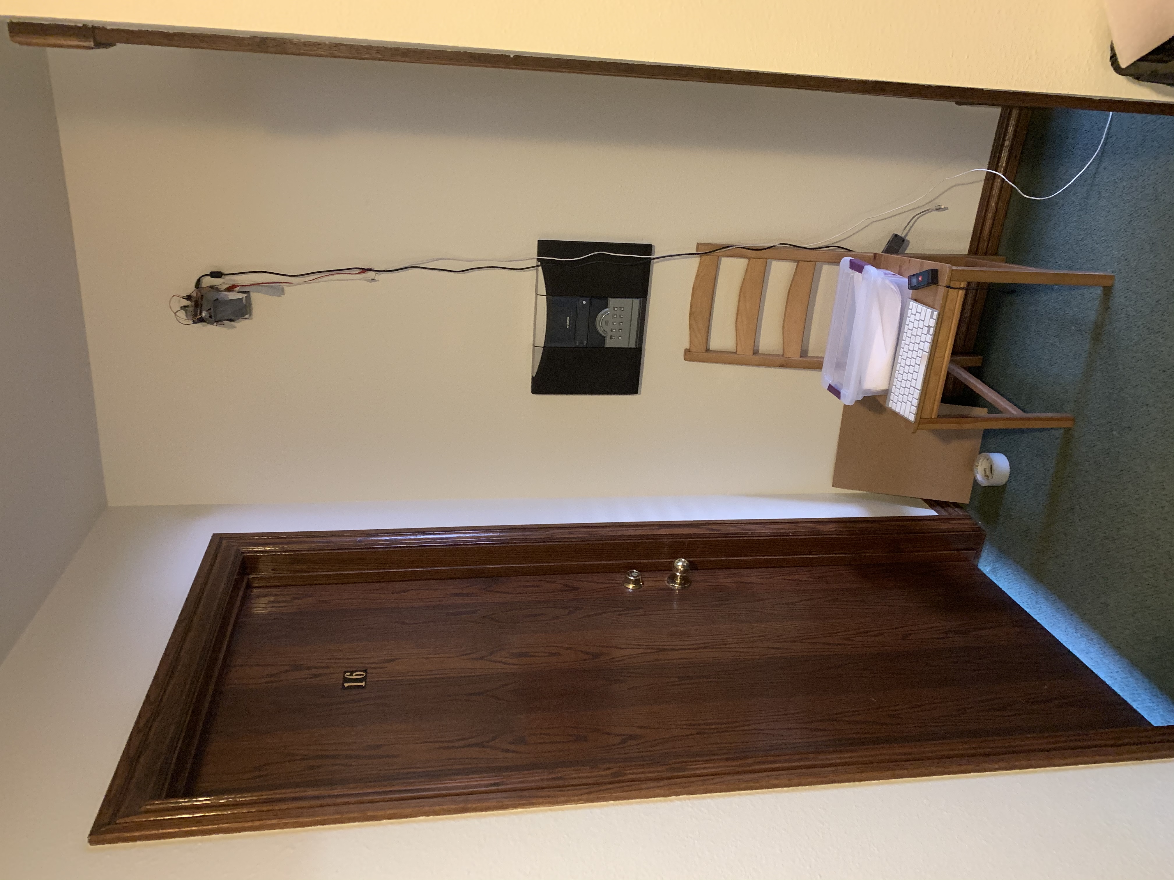

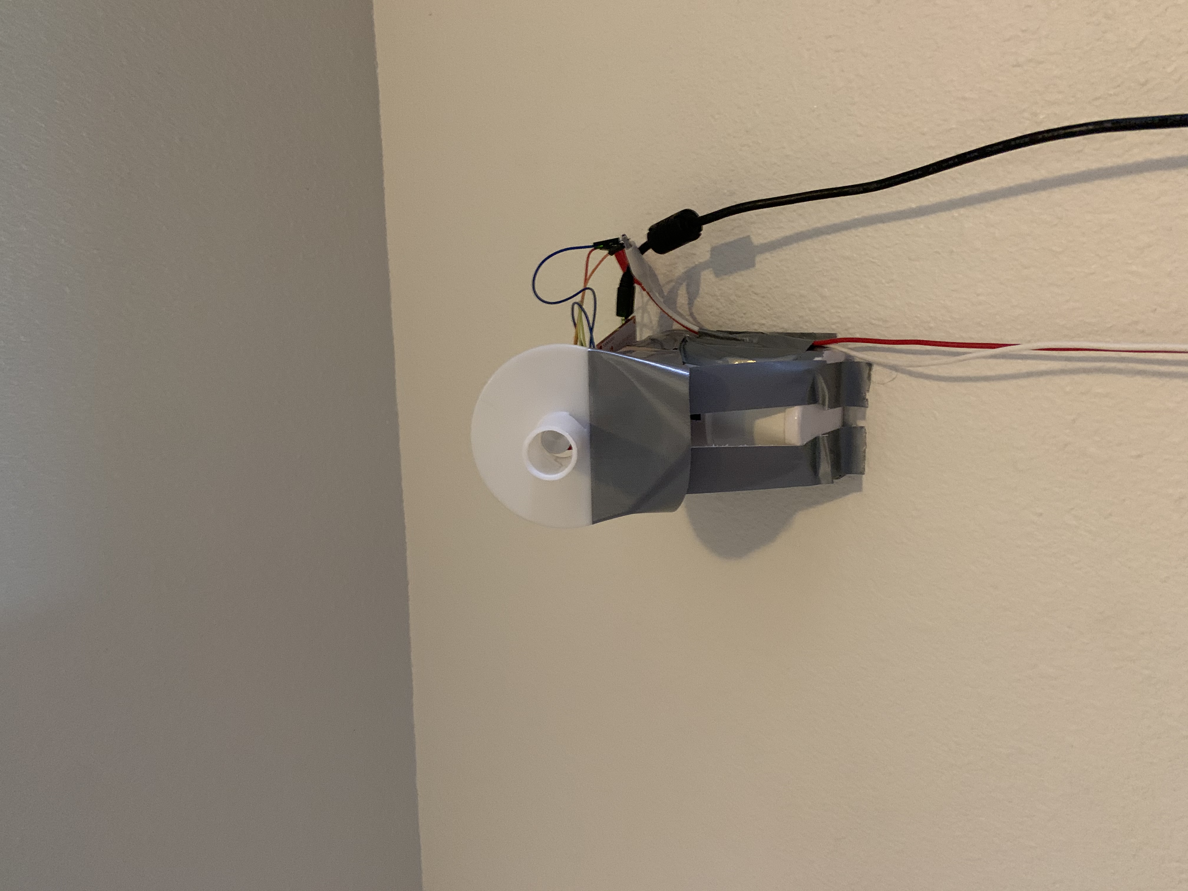

Here is my setup. I have the transducer mounted about 2.2 meters above ground pointed downward about 35 degrees.
I am using these settings

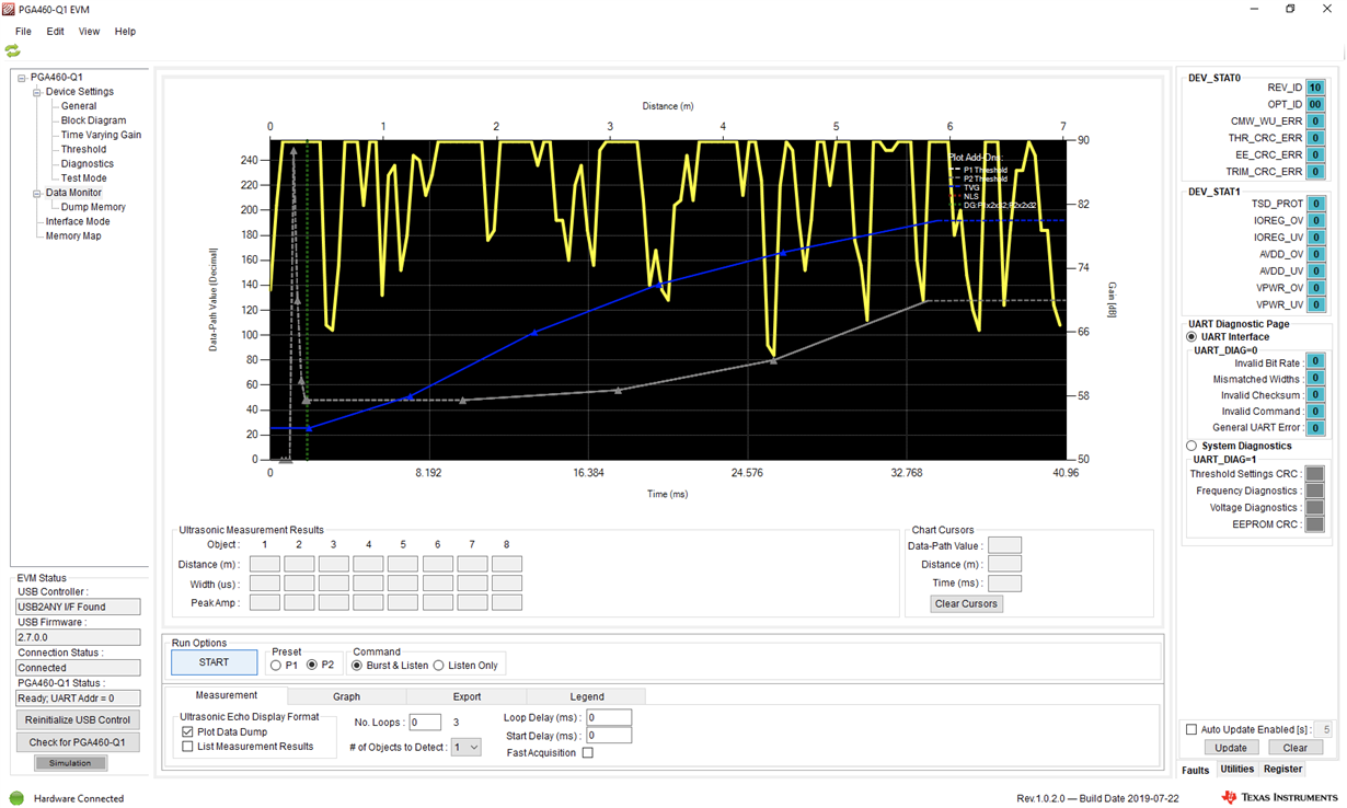

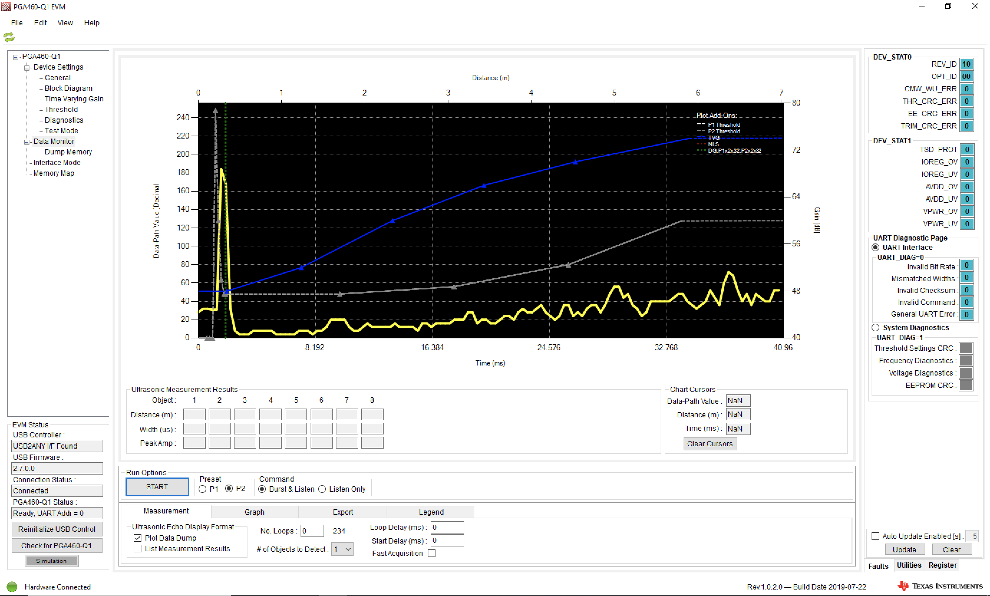

These are the results I get when I am stand 2 meters away from the transducer and take a reading. I am wearing a cotton shirt and shorts.
I am expecting to see a spike at 2m where I am standing but I don't see anything. Are these the results I should expect? I have tested with a flat piece of wood within a meter of the transducer and have been able to see results. I am just surprised because from my reading of the documentation from TI I should at least be getting something.
If I should be getting better results please let me know what things I should test. I have a fairly basic set up and am using the TI evaluation hardware so I am not sure what could be going wrong.

    2) From your GUI General page snapshot, I see you are mostly using the factory settings from the PGA460. In the factory settings, the problem is that Preset 1 tends to be too weak, while Preset 2 tends to be too strong. Attached is the configuration used as part of the Design Guide results for the PGA460PSM-EVM with the 40kHz PUI Audio transducer. This should serve as a better starting point for the hardware solution of the PSM.

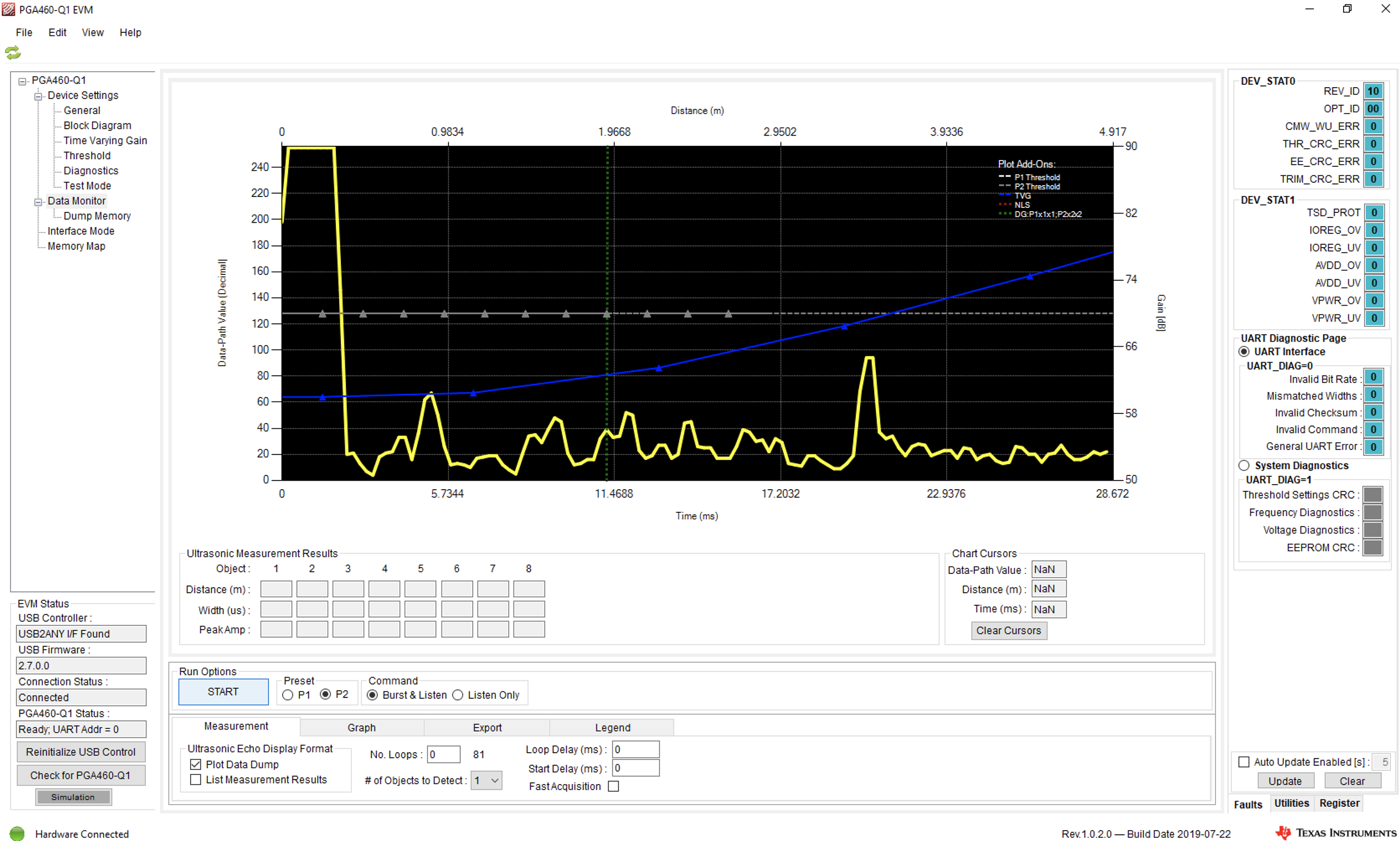

  • Akeem,
    Thank you for the suggestions. I removed the BOOSTXL_PGA460 and am now just connected using the UART and an external 9V supply that is connected to the PGA460PSM-EVM and ground of the MSP-EXP430F5529LP. I am also using the TXT file with the Design Guide configuration.

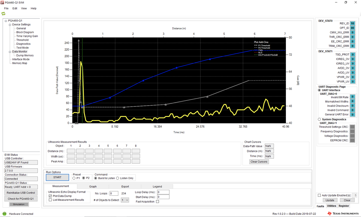

    I am still unable to detect a person standing in front of the wall from any distance away. Here is another screenshot of the GUI with someone standing 2 meters away the wall that the transducer is mounted to.

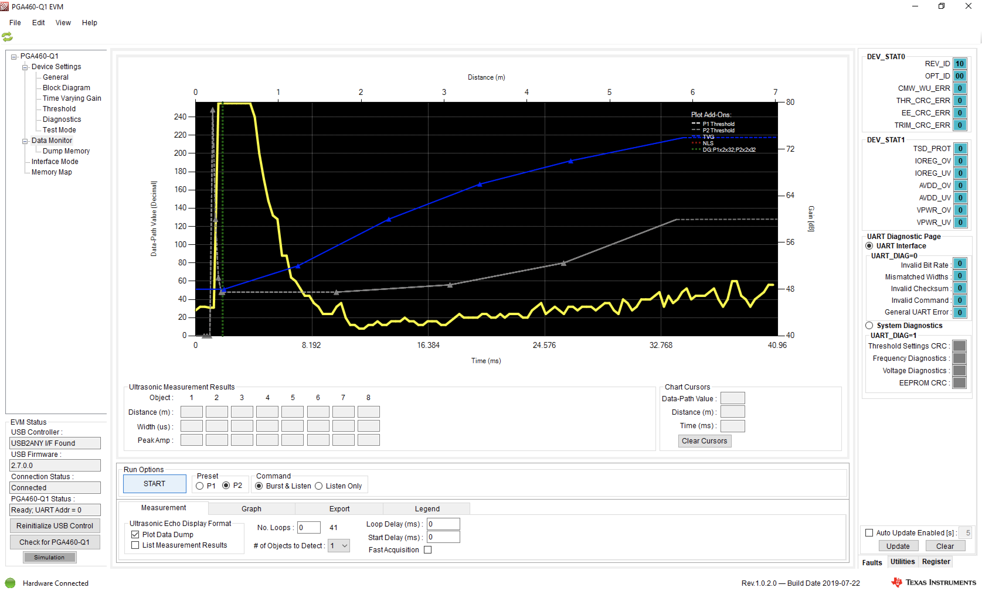

    I tried turning up the AFE gain range from 46-78 to 52-84 in the Device Settings and then everything is way too amplified (screenshot below). For some reason the whole configuration gets messed up when I do this because when I change the setting back to 46-78 I still get results like this screenshot below. I am unable to get rid of this noise until I read in the TXT file again and update the entire memory map.
    I also created a small horn using a plastic tube
    And it gave me this when someone was standing 2 meters away from the wall in front of the transducer.
    At this point I am not feeling very confident at all in detecting the distance of a person using this setup. I have also tested holding up a large flat piece of plastic and have only seen very small spikes that barely rise above the noise floor.

    I agree that the MaxBotix sensor will perform better due to the open-top transducer, which leads me to my next point. The PUI Audio transducer on the PGA460PSM-EVM is intended for harsh environmental / outdoor conditions. Assuming your application is exclusively indoors, you could replace the transducer with an open top for improved sensitivity. Note: the PGA460PSM-EVM is a transformer driven board, and the transformer driver isn't necessarily required for an open-top transducer. We typically recommend a direct-driver for open-tops, but it is still possible to use a transformer with an open-top. Just be sure to limit your preset driver current limit between 50-100mA and try to minimize the voltage at the center-tap of the transformer. 9V should still be OK as long as you limit the driver current limit. Here is a list of transducer part numbers with their specifications. Filter parts by construction type = open:  PGA460 Transducer & Transformer Listing. If you want to experiment with the direct driver, you could use the BOOSTXL-PGA460 EVM since this option is available on the included daughtercard.

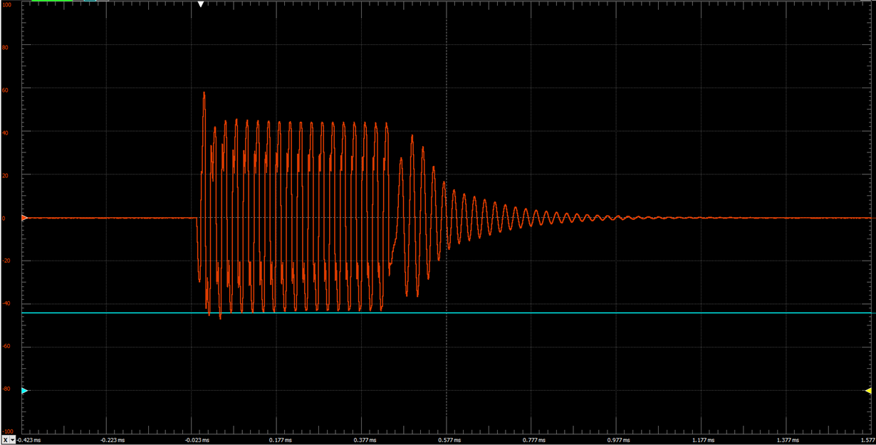

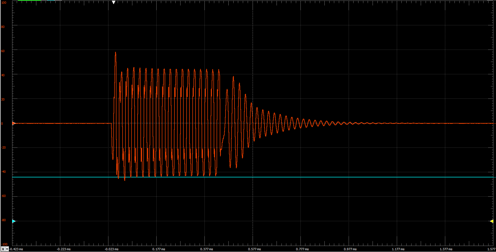

  • Akeem,
    I checked the excitation driver and here are some screenshots of the waveform at the transducer.
    As you can see I am getting about 90Vpp. What concerns me is the shape of the excitation. I was able to get the waveform to look more smooth without that spike when bringing the current limit down to around 200mA.
    I double checked the power supply voltage and it is a clean 9V. I also tried going up to 18V without any change in the excitation waveform. I am unable to get the waveform anywhere past 90Vpp. I tested this on 2 different EVMs that I have with the exact same results.

  • Hi Josh,
    I've observed similar excitation waveforms for this particular transducer, such that a notch can be present in each cycle of the sinusoidal burst.
    The PGA460PSM-EVM transducer matching component values were selected based on a combination of minimizing decay time and maximizing detectable range. The sinusoidal driver integrity may appear to be compromised due to the notches, but the transducer is still able to generate sufficient sound pressure level. If you'd like to clean-up the sinosoidal waveform, you can change the C_Tune matching component (capacitor in parallel to the transducer). This will require some trial-and-error experimentation, but may also impact your min/max range performance.You can see the impact of the inclusion or omission of specific matching pair combinations in Figure 16 of the Ultrasonic Proximity-Sensing Module (PSM) Reference Design for this particular transducer.
    The driver current limit definitely has a more significant impact on the peak-to-peak excitation voltage than the center-tap voltage. Spot checking the transducer performance as a sweeping function of current limit versus center-tap voltage, the peak-to-peak barely changed regardless if the center-tap was 7V or 15V. Meanwhile, the peak-to-peak voltage nearly doubles from a current limit of 100mA to 300mA. Note, the center-tap should be limited to a max of 15V because the center-tap value doubles at the OUTA/B pins, which have max ratings of 30V. You can continue using your 9V supply.
