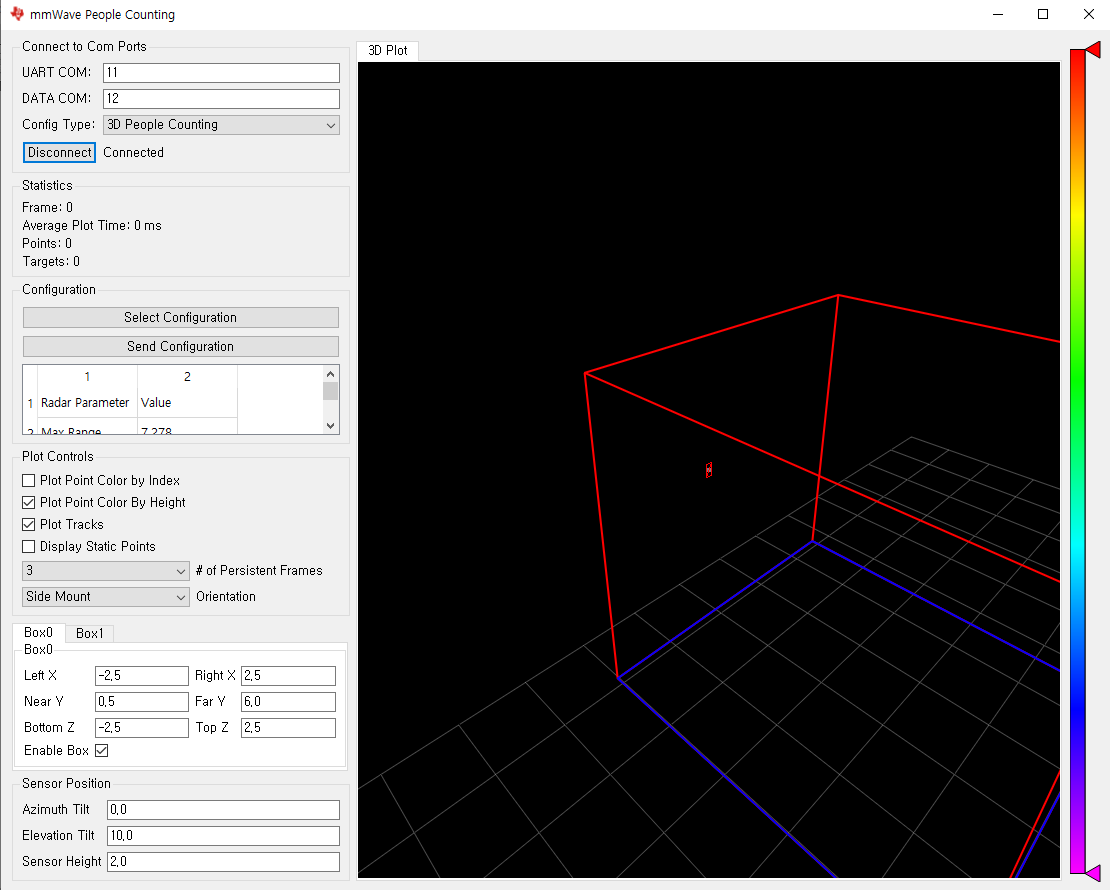

My customer asked me posting this question.
They've done calibaration using corner reflector and out-of box demo. The corner reflector was far 3 meter way.
they got compRangeBiasAndRXChanPhase value
compRangeBiasAndRxChanPhase 0.0861398 -0.94867 -0.31622 -0.49710 -0.08017 -0.49857 0.35611 -0.26758 0.55948 -0.14725 -0.26050 -0.04517 -0.31622 -0.35373 -0.24762 -0.32910 -0.34341 0.35068 -0.01559 0.49985 0.11664 -0.43051 0.35223 -0.19150 -0.62918
They added compRangeBiasAndRXChanPhase to cfg file like attachment and try to run 3D People Counting Demo but mmWave Visualizer doesn't update frame. Would you advise me what step they were missed?
