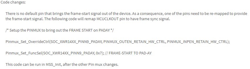

    I have read that thread. I don't have another MCU that can provide SYNC signals for two AWR1443 so I cannot use the method proposed by that thread. According to the thread below, the first AWR1443 can provide synchronization signals to the second one, so I want to try this method to synchronize the two awr1443 boosts.
    According to this thread, I need to change the code before the synchronization betweent two awr1443 so that the MCUCLKOUT  pin of the first awr1443boost can be remapped to have sync signal that can be provided to another awr1443.
    But I don't know how to use this code and what is the MSS_Init?

    I have already read that thread. According to that thread, the MCUCLKOUT  should be remapped to have frame sync signal. But I think this step could be omitted. Now I find that there are two pins on AWR1443BOOST, namely, J6.18(SYNC_OUT) and J6.9(SYNC_IN). J6.18 is an output port that can output frame synchronization signal and J6.9 is an input port that can provide frame synchronization signal for frame start. So if I connect J6.9 of the first radar with J6.18 of second radar(the GND pins of two radars should also be connected. ), then select hardware trigger mode when configuring the first radar, will the two radars can transmit and receive frame simultaneously?
    Thank you.
  • SYNC_OUT line mainly being used in the cascade mode, where device provide pulse at this line to trigger frame on other connected slave device.
    In case of single chip like AWR1443, alternative of SYNC_OUT is over MCUCLKOUT and internal frame start signal is pinmuxed to this MCYCLKOUT pin which connectes to other AWR device (on SYNC_IN) line for frame trigger.
    Jitendra
    According to that thread, MCUCLKOUT  pin of awr1443boost can be remapped to have sync signal, and we need to run the following codes.
    But I don't know how to use the code, could you gave me some details about how to run the code?
    Thank you.
  • You need to add this code in mss_main.c file and rebuild the application.
    In the application there is already a pinmux part for UART, you can use this later to that.
    Search for 'Pinmux_Set_OverrideCtrl' in main.c file of mmw demo if AWR1443 in mmWave SDK v2.1
