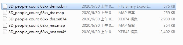

We follow the CCS --> Resource Explorer --> People Counting User's Guide, we flash the prebuilt_binaries and it work correctly. After test, we try to rebuild the project. After flash the binaries, they cannot work with "mmWave People Counting GUI" Please tell me how to create workable file. BTW, the binary files are smaller then prebuilt_binaries

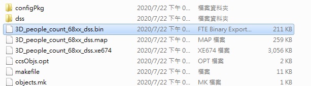

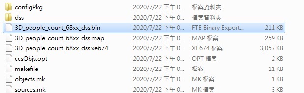

After using CCS - 8.3.1 and verify all the software version. We still cannot create workable binary file with "People Counting project" We also import and rebuild the "mmwave_sdk_98xx_aop_hwa". The binary file work correctly. Do we miss anything with "People Counting project"?
Hi Kimi,
In the picture you have in the original post, you are showing the DSS project. Did you also import and compile the mss project?
