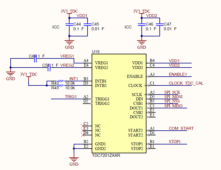

Dear team,
Would you kindly help review the schematic of TDC7201?
Thanks.
Sammi

Hi Sammi,
I see no issue with the schematic assuming they are using the single SPI channel mode. The schematic appears to be based on the TDC7201-ZAX-EVM, which is our recommended schematic template for the TDC7201.
