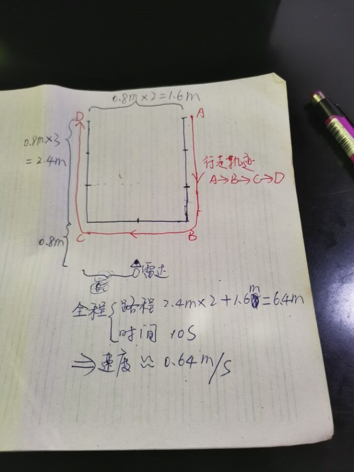

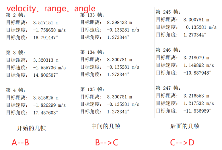

As shown in the picture is the track of human walking(A-->B-->C-->D). The radar is located at the origin. When people walk far away from or near the radar, the speed can be detected. However, when people walk along B to C, the speed is close to 0。So I would like to ask if the radar can detect the speed of objects moving parallel to it (such as B-C)?
